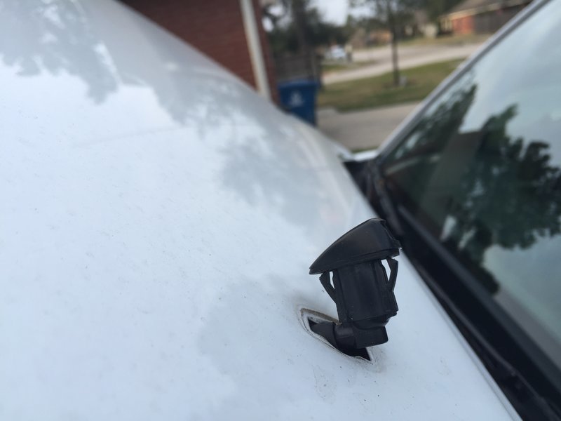

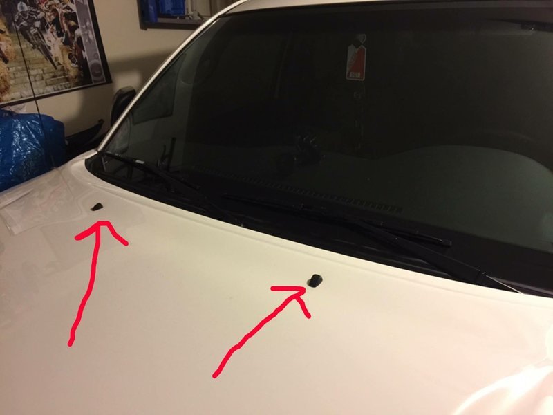

    Does anybody know how to take these windshield washers off? I'm trying to put a Hood blackout for my 2014 Tacoma and I can't find any video or instructions how to take them off. Thanks!IMG_9244.jpg

    Underneath, you have to pinch the front and back then they pop out. Should be kinda like two little flex tab things.

    It's underneath the washer not the hood, right? You just used your hands to pinch it?

    Open the hood and look at them from underneath, it should be obvious then :thumbsup:

    I forgot to post it this afternoon before you reply but thank you for the reply. I tried it as soon as I got home and was able to take it off. The rear tab is a little bit tricky. I did the front first then the back. Posting a picture here for @Big Sky Country IMG_9249.jpg
