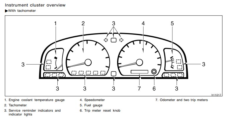

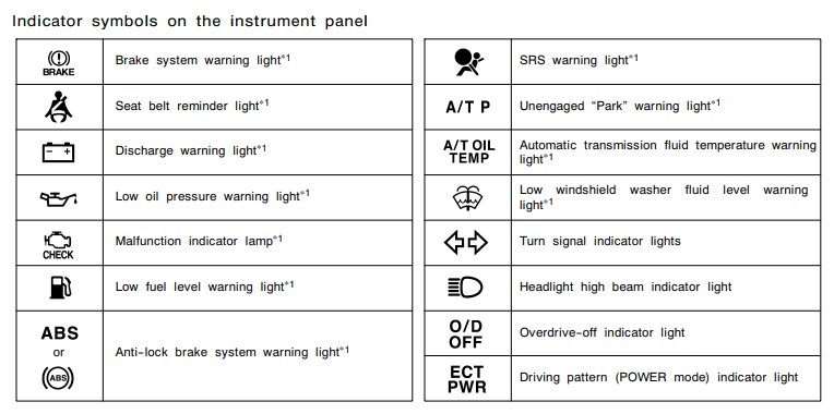

    I need to replace my washer fluid tank. I've studied the dash symbols with ignition on to try and find a washer fluid warning light that comes on with ignition triggered. I have the usual warning lights that come on when ignition is switched on, but I don't find a low washer fluid light symbol anywhere.
    2003 Tacoma Instrument Panel.jpg If there is a "low washer fluid warning light", where on the instrument panel would it be?
    Is it possible my rig is NOT equipped with the low warning light? I need to order a new tank, but want to get the correct one. Appreciate some insight. Thanks...

    from the owners manual:
    The low washer fluid would be in one of the two bottom outer most (3 - Service reminder indicator and indicator lights) positions.
    I bet your truck has the indicator. Just check the existing tank to see if it's got a plug on it or not :notsure:

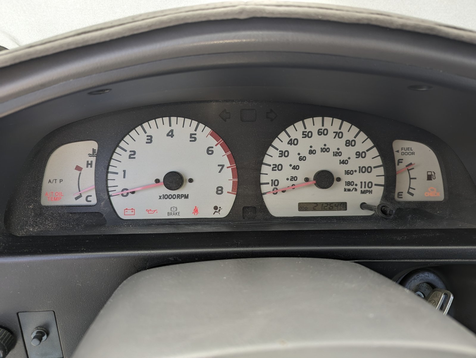

    I was wondering the same thing on my ‘04 PreRunner, then my light came on between speedometer and gas gauge(bottom right). You could just use the washer till the water runs low enough, the tank would also have an electrical plug-in to make that light come on. I believe you can access through passenger side wheel well by removing the liner and check.

    Okay, thanks for responding. The pic of the instrument display with all the spaces listed as #3 is my clue. Not every light comes on with the key triggered - everything black and not activated had me hoodwinked. I'll double check, but do believe its wired. The neck of the tank exposed below the cap is rotten. The tank still holds water, as I can trigger the squirt gun on the lever with wiper controls. Appreciate the response from all. Thanks again...

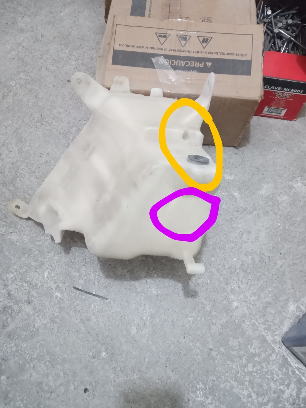

  9. Apr 19, 2024 at 8:08 AM
    San Lorenzo
    San Lorenzo Well-Known Member
    Apr 16, 2020
    #324923
    53
    Juan Ramon
    2003 Tacoma
    Yellow=pump
    Purple=Empty reservoir sensor
    THIS ONE IS W/O SENSOR !!
    rocknbil likes this.
