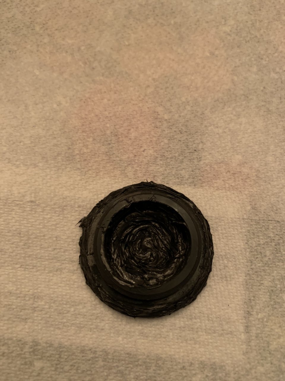

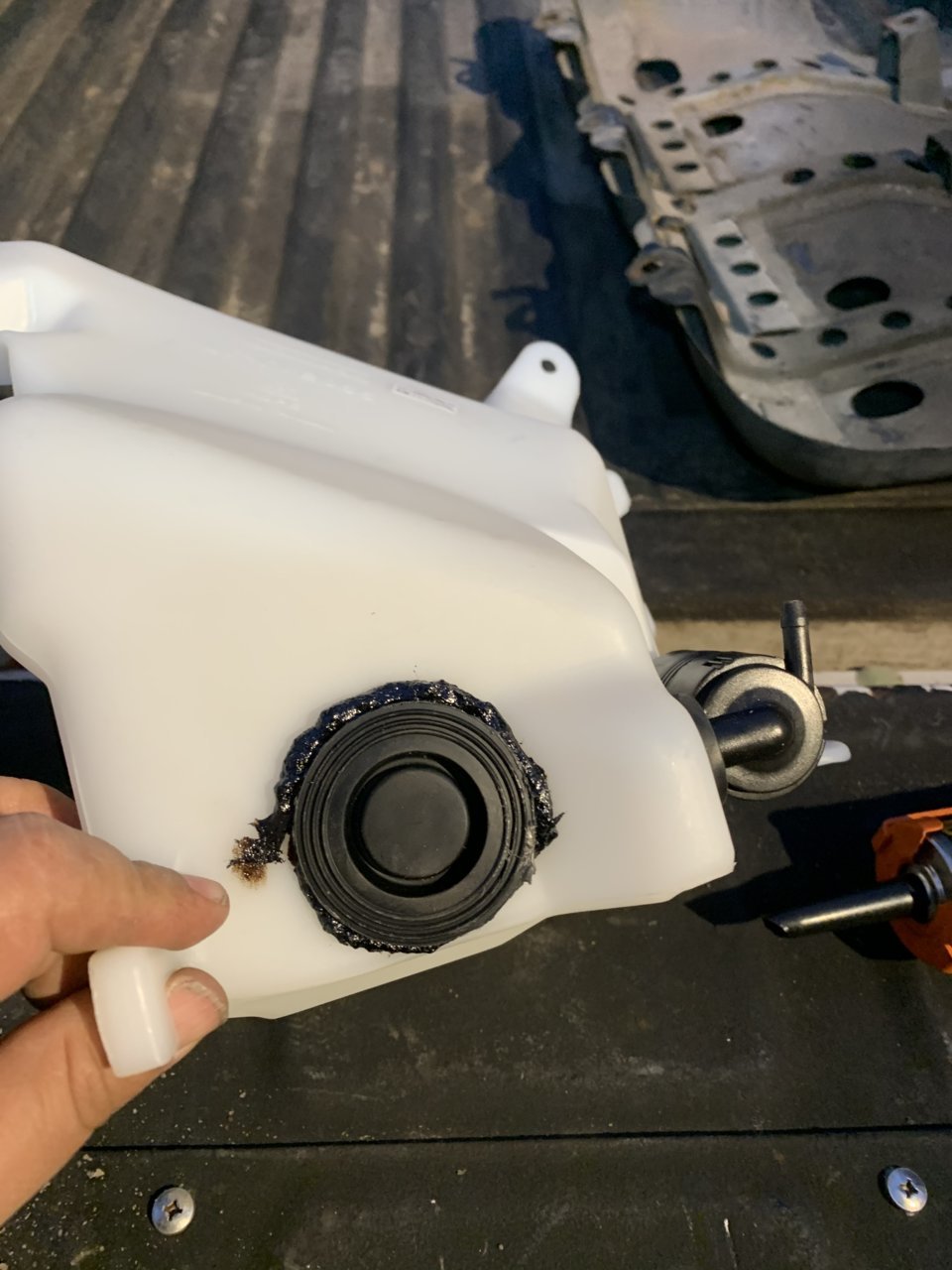

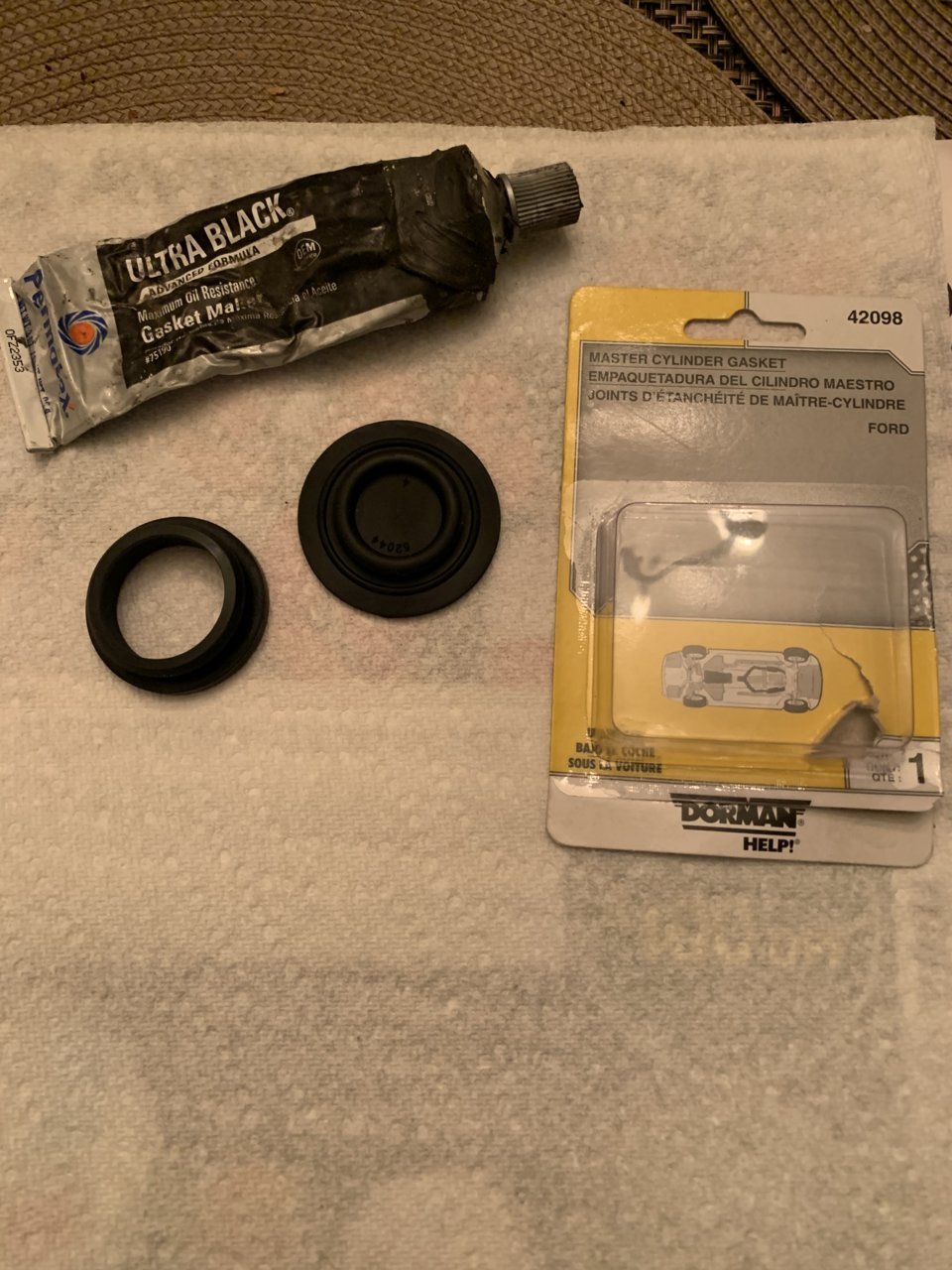

    my container came with new pump though, and a grommet where additional hole is at bottom:
    so i went to autozone and bough this master cylinder gasket, which fits right into grommet, i used gasket maker to create seal and let it sit overnight.
    next morning put some more gasket maker on to container and put in grommet into container.
    installed container as usual.
    hope that helps.
