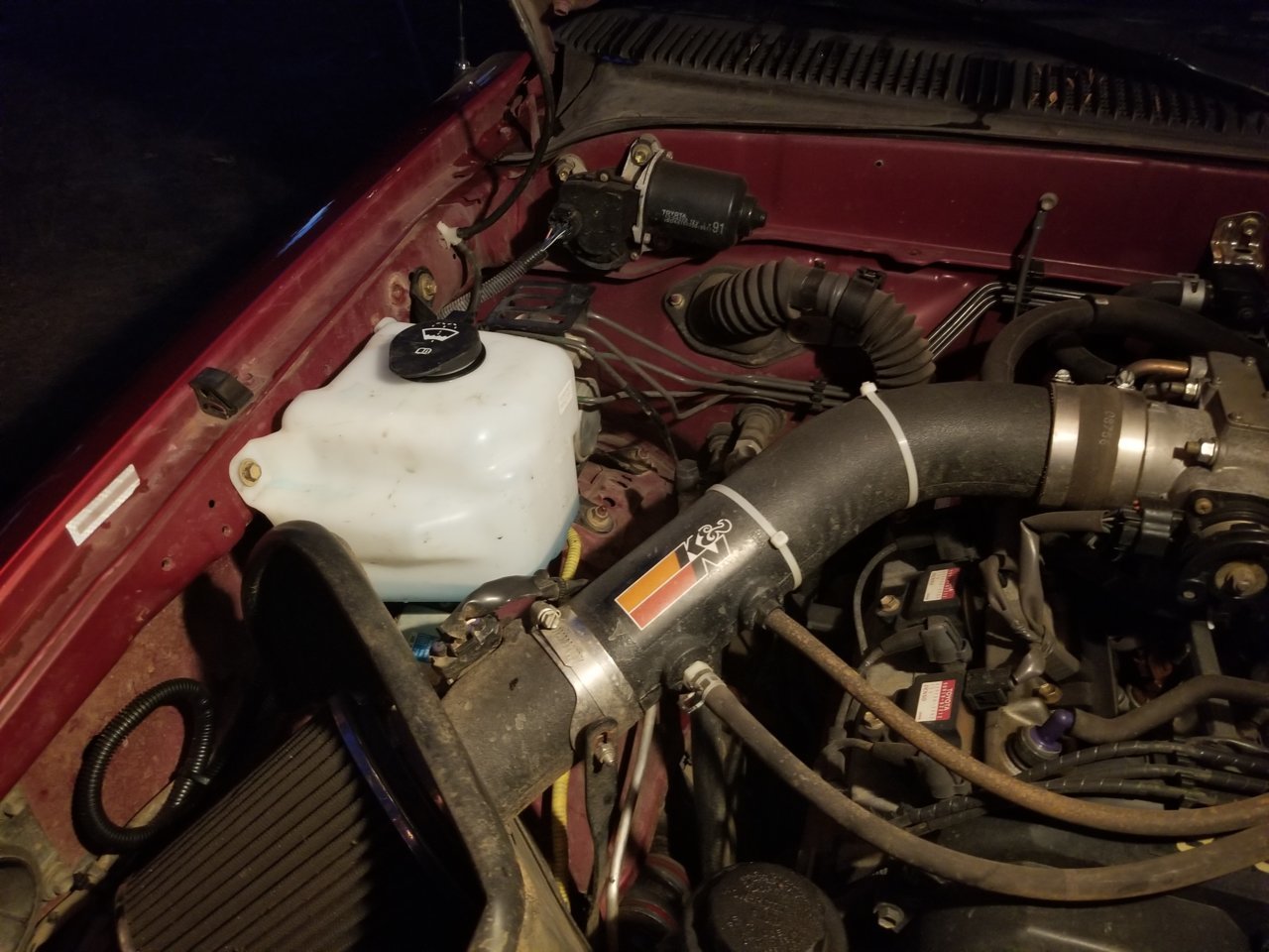

    So question on that, did the wiring connect right up or did you have to rewire it?

    I used my old pump and sensor.
    That's one thing I forgot to mention is that the new one didn't have the extra bit that has the low fluid sensor, so I used a step bit to drill a hole in the bottom of the new tank, and reused the gasket and pump unit. It was quite easy.

    Thank you for the feedback. I ordered one myself after seeing this thread lol my fillneck on my oem is gone so it’s been letting dirt in and clogs my sprayers. So ordered new spray nozzles I’d seen in another thread and then ordered this pump and reservoir. I like this placing better honestly. The original housing for the reservoir was kinda an iffy decision on Toyota engineers part. Plus being gm sourced didn’t help.
