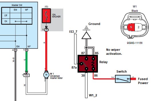

    UPDATE: I’ve gotten everything wired up. I turn the switch on and the wipers start going but not the washers. Maybe I spliced the relay in backwards? I believe I followed the diagram above to a tee. I have exactly 0 idea what’s going on. I’ll attach some pictures of what I got going on tomorrow, it’s time to pack it in for the night.

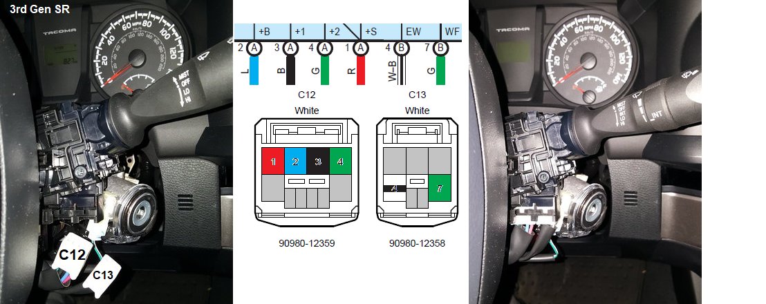

    C13 is the washer...

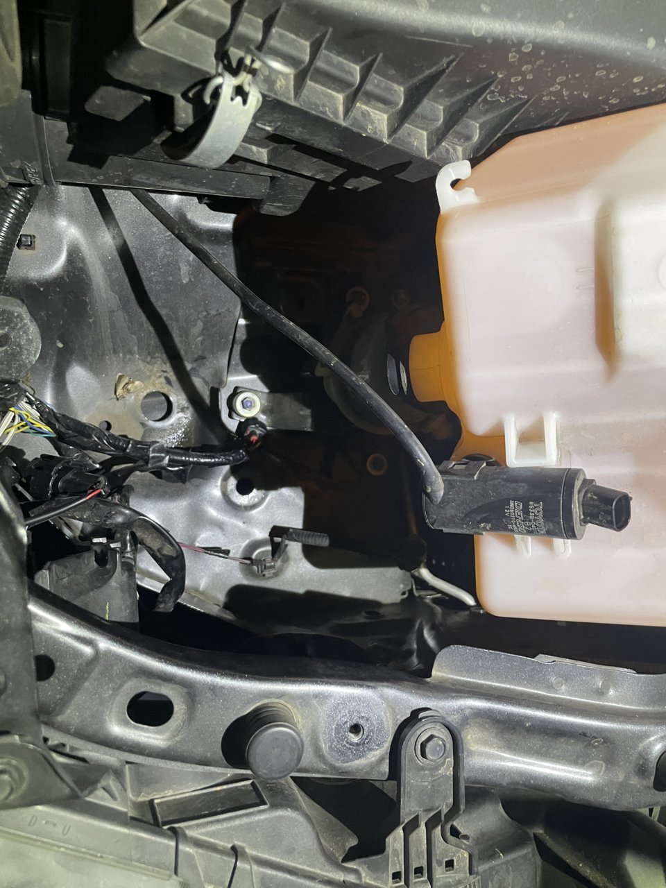

    I’m not working from the stick like that. Right now everything I’m working on is at the pump by the reservoir. Is there not a way to splice into the washers from the pump?

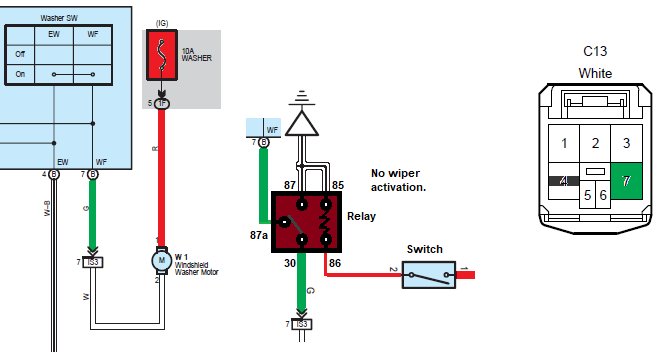

    I’ll send pictures of what I got tomorrow. Basically I have everything on the right side of that picture correct, only difference I suppose is the two white wires are the pinkish/red wire connecting to the pump spliced into the relay. The wipers come on with the switch but not the washers. There’s a second white wire coming off the pump that I figured was a ground, but maybe the pink controls wipers and the white controls the washers. I have no clue, and again I’m very very new to this. It took me like 20 minutes just to interpret parts of that diagram. So, is there a way to wire a switch to turn on the washers from the washer pump?

    I’ve been as specific as I think I can. I’m trying to wire a switch to turn on the washers externally via the washer pump under the hood. I’m not trying to splice wires in the cab as I don’t want to run wires through the firewall. I’ve given pretty much everything I can except it’s purpose. I wouldn’t pull my reservoir out just for trolls, I need some honest help on this one.
