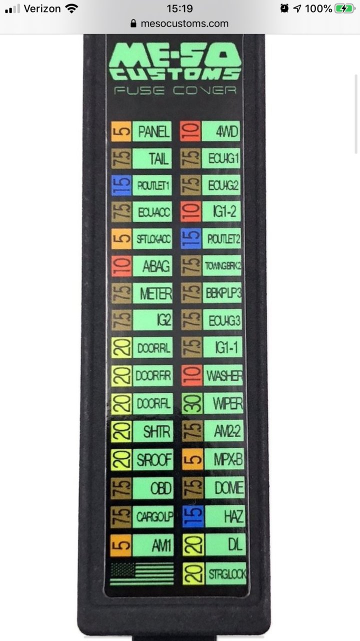

    Which fuse was it? I'm running into the same problem and could use a little guidance to save time.

    It's up under the dash in a little fuse box. It's labeled washer and it's a 10 amp fuse.

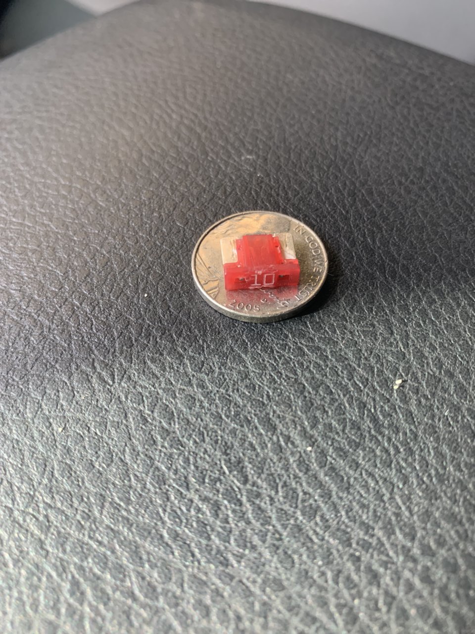

    Sorry never saw the quote notification. Hope you got it figured out. It was the one in the kick panel and it’s one of those really small 10 amp one.
    Nickel for scale as that’s what I had close by
