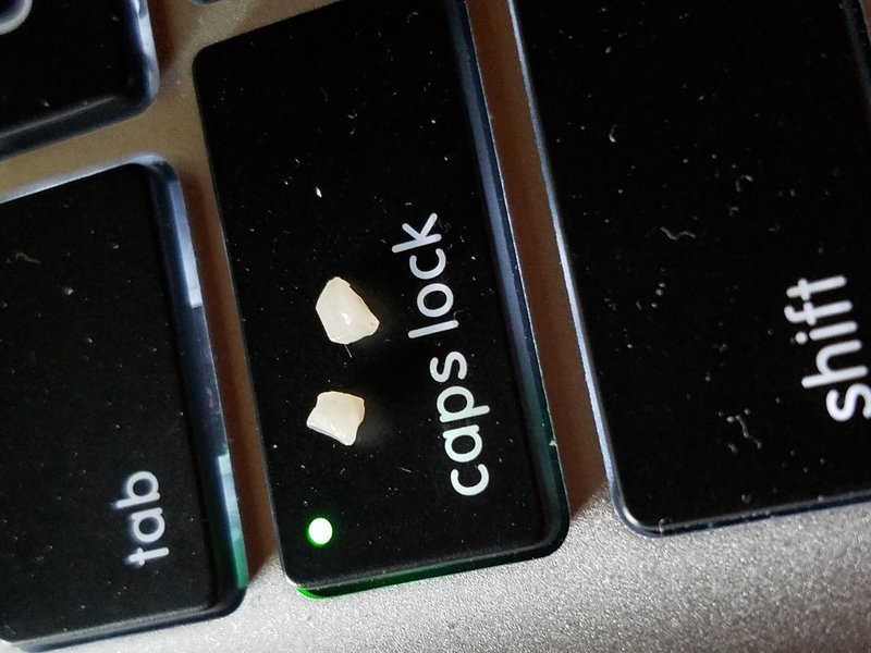

    I'll probably look into new nozzles anyway but I got probably like 7 rocks out of the driver side nozzle which was the worst and these were the two biggest haha. Haven't put them back in yet but the difference in air flow is remarkable. Putting my money on the nozzles that were just clogged
