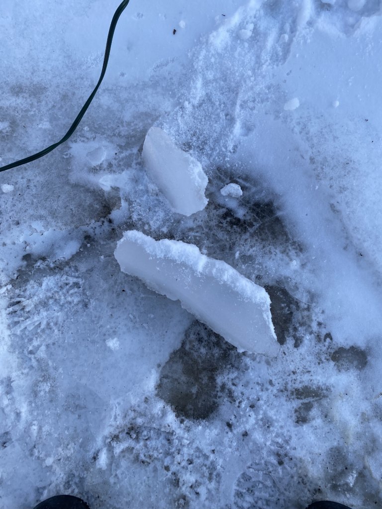

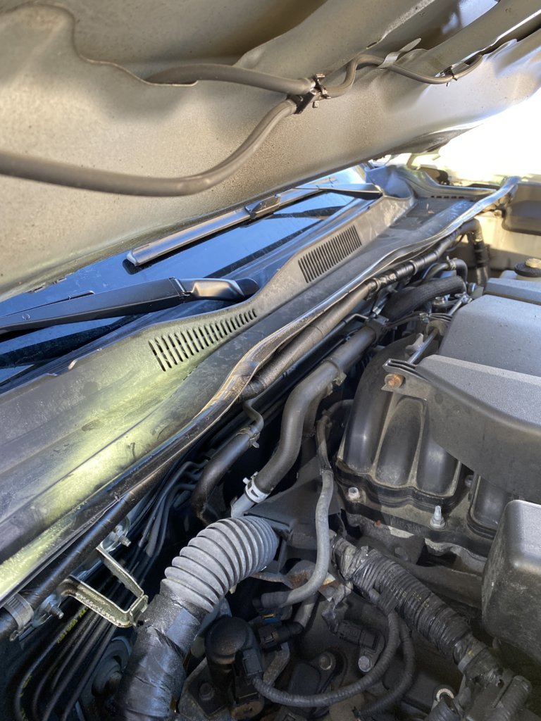

    Problem solved! Thanks for all the replies. Whoever mentioned the vents on the cowl was on the right track. The storm on the weekend dropped about 4” of hail and it looks like after the top of the cowl filled up, the ice pellets started rolling under the hood and into the vents on the cowl. I peeled the front edge of the cowl up and melted it free with the wife’s hair dryer, then was able to reach in and pull the ice out. Was about a foot long chunk of ice, so I can see why the wiper arm couldn’t move through its whole stroke.
