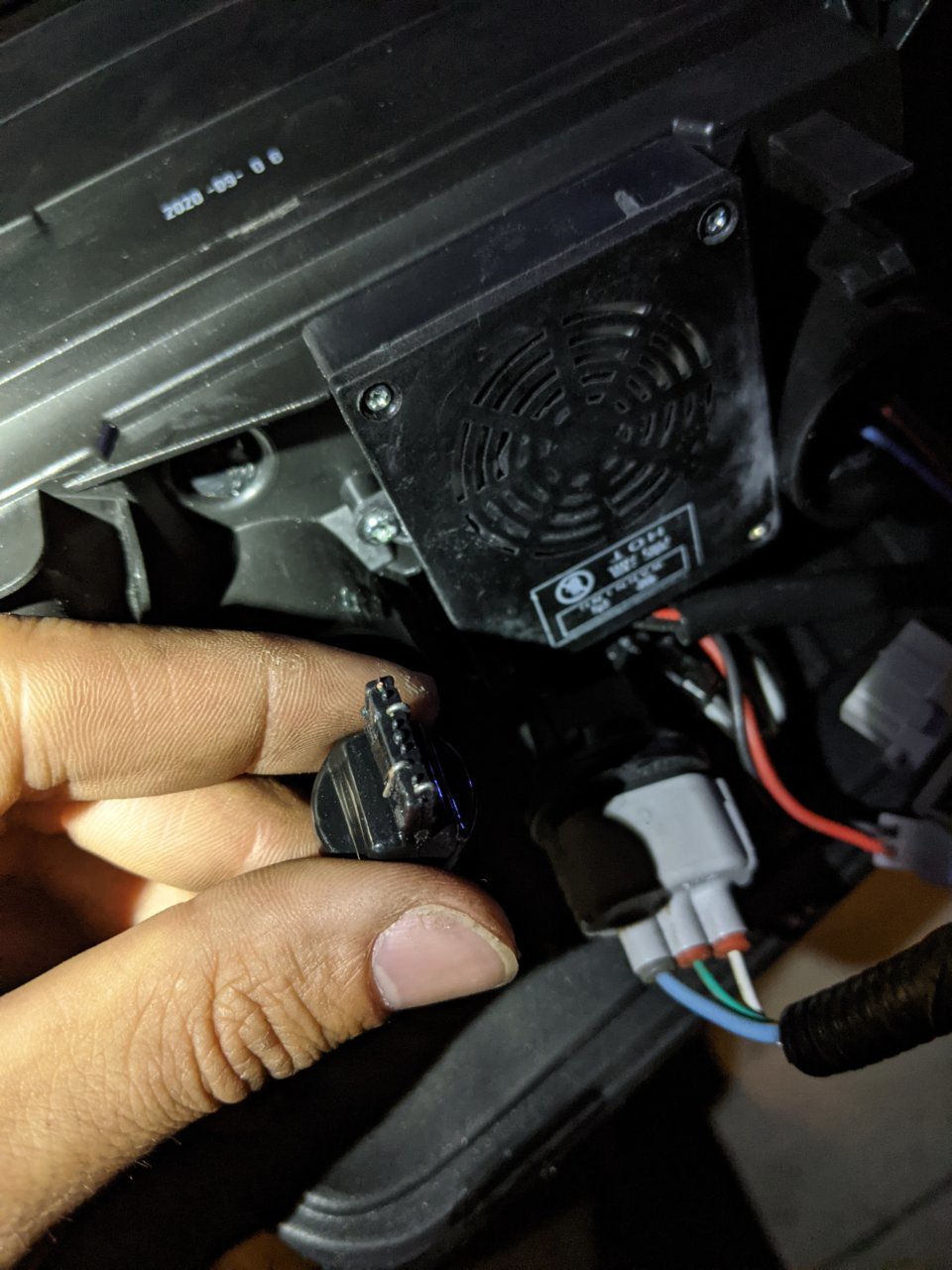

    Installed today. Problems.
    Brake lights and turn signals work.
    No running tail lights.
    I changed out fuses. Not the issue.
    I put the regular bulbs back in and the tail lights wont come on.
    There is still power going to the tail fuse.
    Not sure if this was caused by the Winjets or not, but now my **** is ******.
    I literally broke 36,000 miles today.
    I looked at the connectors from the winjets..
    It looks like several are broken (they should be wrapped over the top. top image missing 1, bottom is missing 3!
    Anyone have advice for me?

    Honest advice? Return them. This whole thread is riddled with people having issues, often unresolved, and others doubling the fuse current rating which is not a good idea. If the circuit has a 7.5 amp fuse, the wiring is unlikely to be gauged for carrying twice the current with the appropriate margin. I'll bet my lunch that long term using larger fuses to support the added current these poor quality lights draw will cause connector and wiring issues if the lights last that long.
