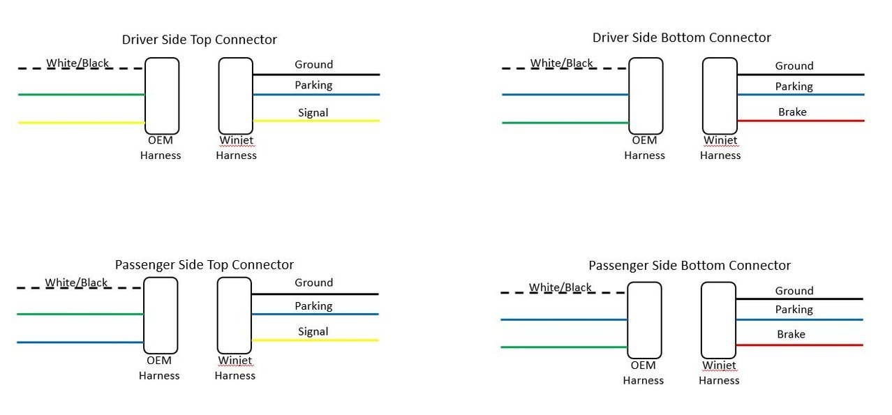

    Anyone on here a wiring expert? I have been toying with the idea of re-wiring the winjet tails a little bit. What I want to do is have the signal led's and the brake led's all become brake led's only. Then I want to turn the parking light into parking light and signal.
    I have mapped out all the wiring and I know which wire on the winjet housings do which role, but I want to make sure I can wire them up correctly. More concerned about the parking/signal light.
    Top picture is the wire map out as it sits with my tails. I know the color on the winjet housings can be a little difference as mine are different than what I saw in the video.
    Bottom picture is how I think it would be wired up to achieve what I'm looking to do.

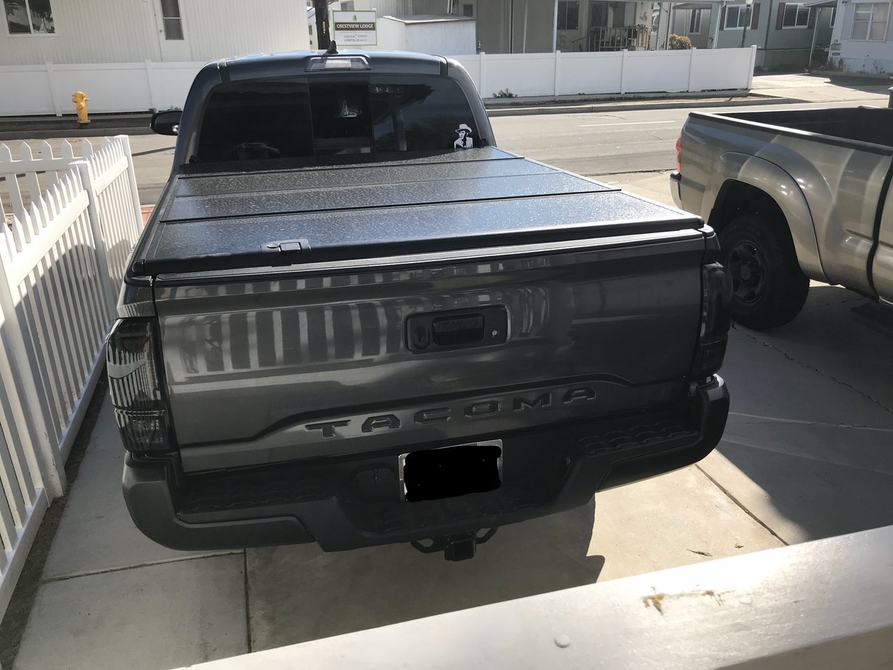

    C803B9E5-0032-490C-988D-F22794927989.jpg 41133F6A-F24F-48CC-852D-2C26E452D688.jpg

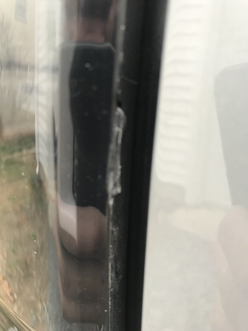

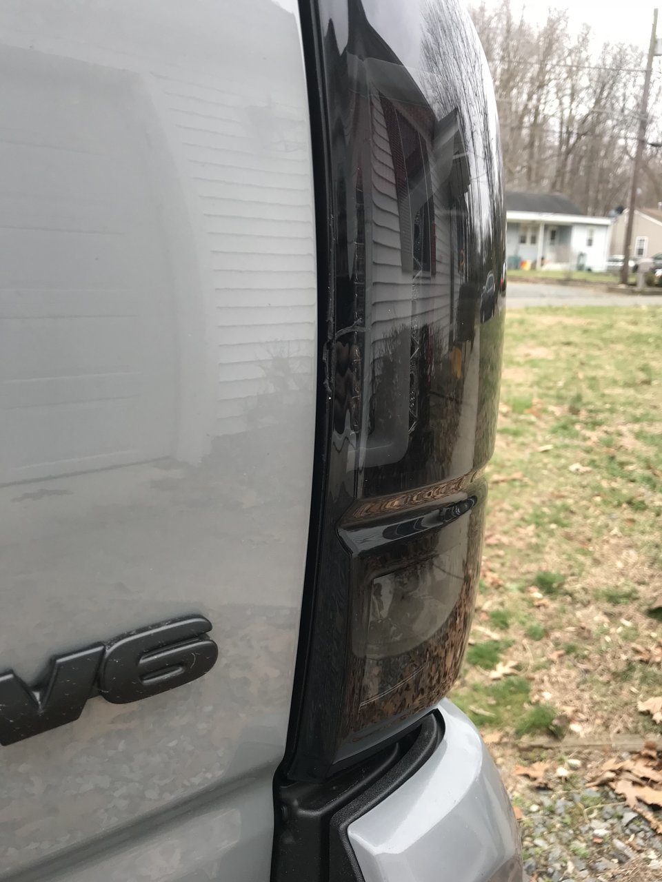

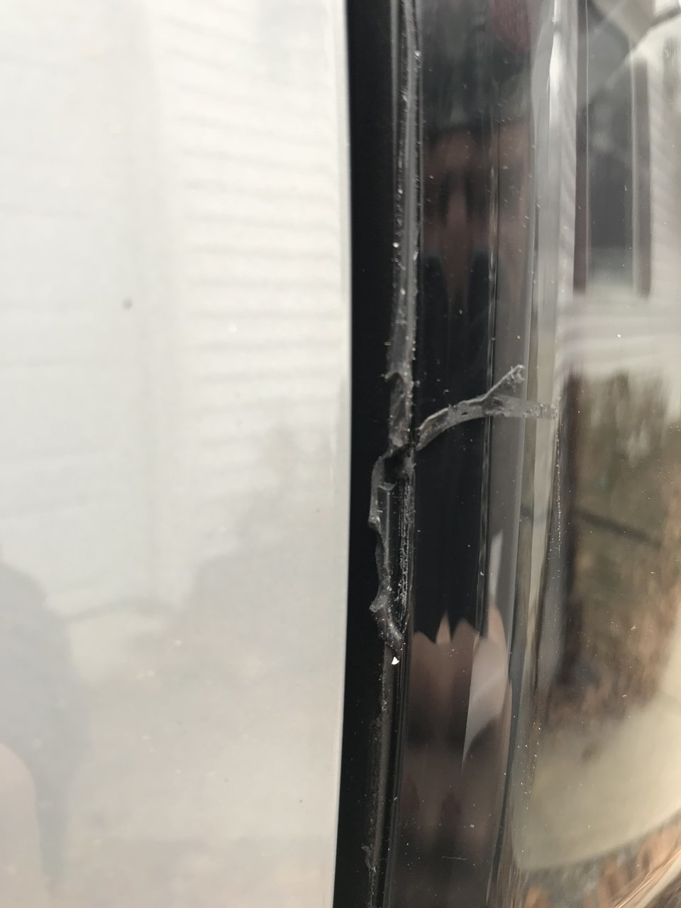

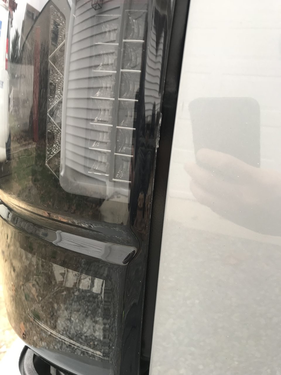

    Anyone else have this issue ? Just put these on, they work fine and look great from a couple feet away.. but upon close inspection both sides have a blemish in the same spot.. I’m worried about moisture getting inside as it seams the blemish is on the seam of where the two plastics meet.. I got these from @TacomaBeast 201877A0-6142-4441-89D4-0E06FAB48818.jpg 30F231F4-2C0B-4CED-A95C-8F00367E35BF.jpg 8653B7B6-85A9-46E9-8070-62161F6950A7.jpg 3C91EE4A-391D-4803-9872-BA48E89C638E.jpg
