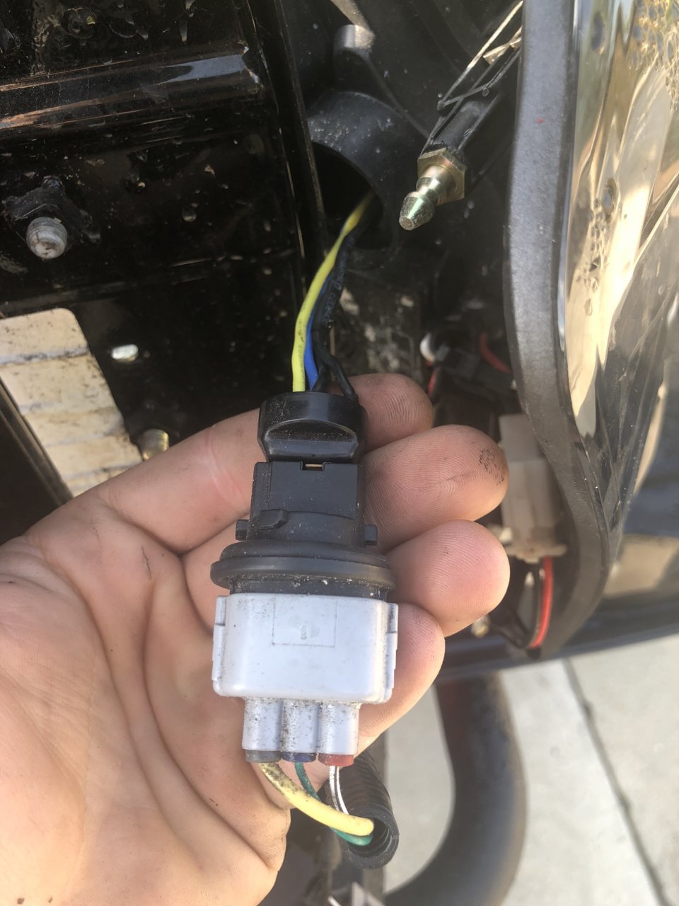

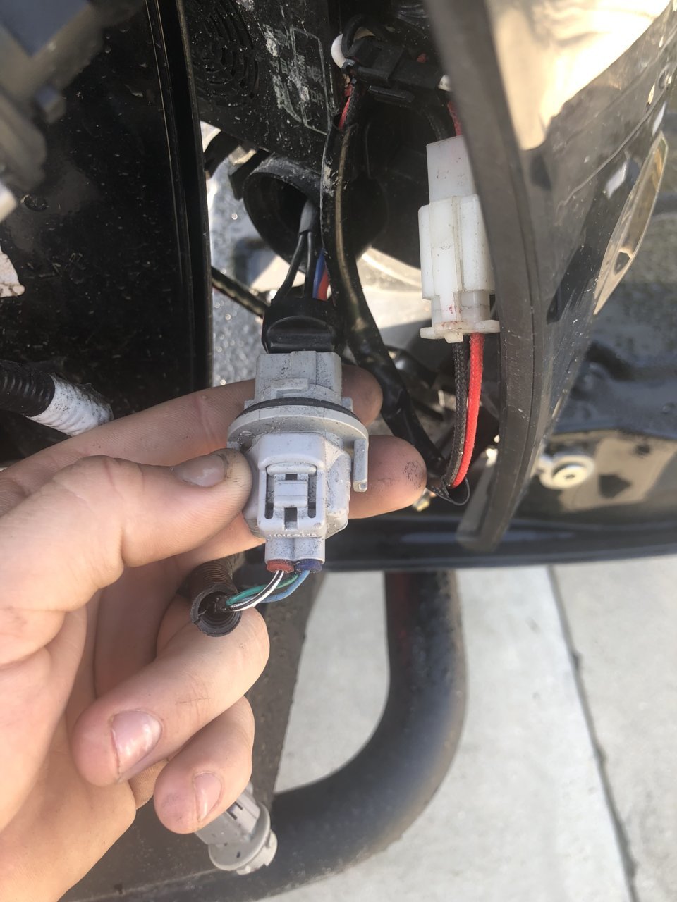

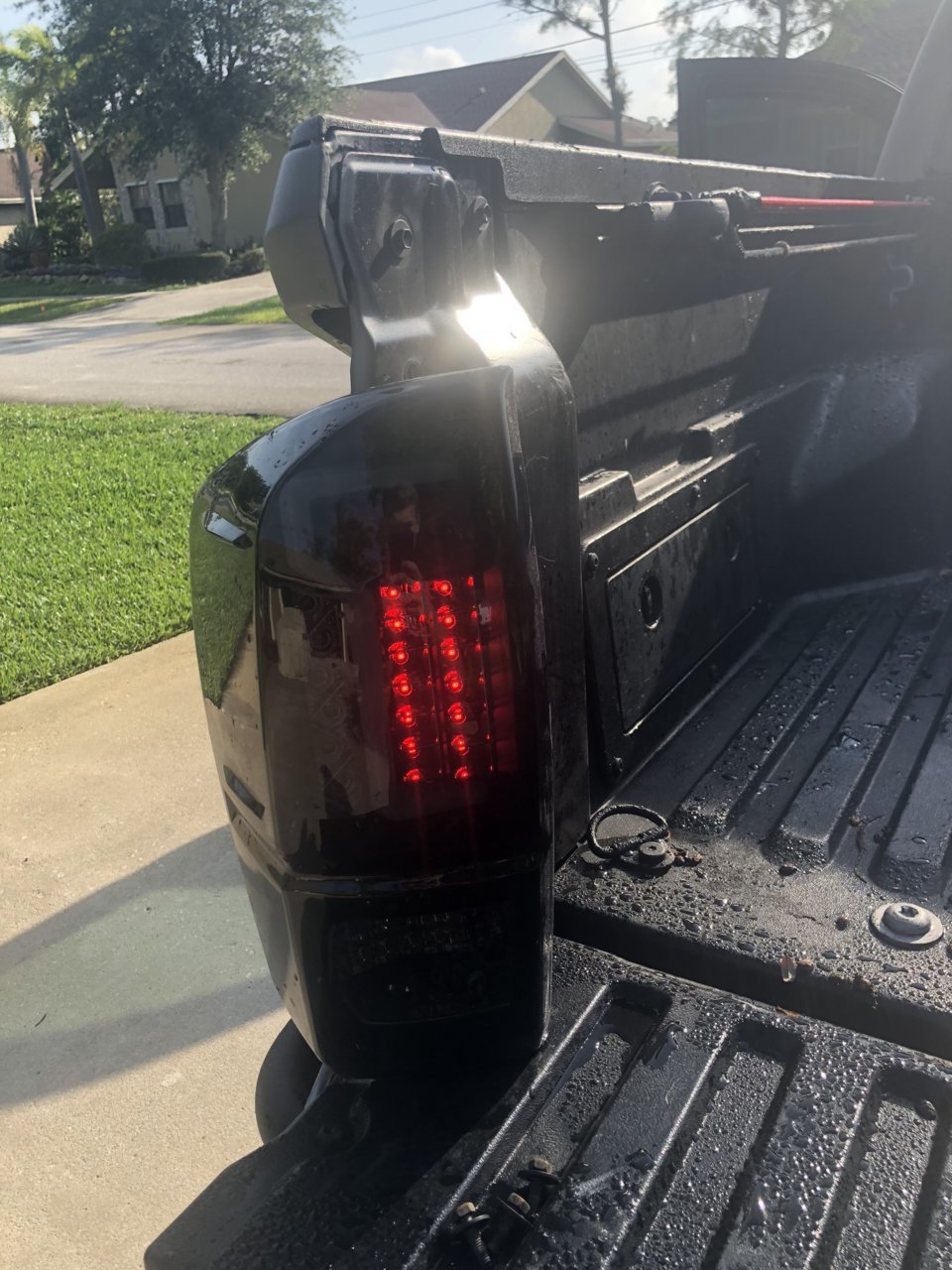

    I actually figured it out. You just have to make sure theyre plugged in correctly and up the amps on the fuses for the stop in the fuse box in the engine bay and then underneath the dash I swapped a 7.5 fuse for tail up to a 15. Everything is now working perfect.

    So
    Engine bay:
    STOP fuse-
    10 amp fuse-swapped- now 20 amp fuse
    Underneath dash:
    TAIL fuse-
    7.5 amp- swapped- now 15 another fuse
    I had all lights working except the running taillights until I upped the ampage in the TAIL fuse.
