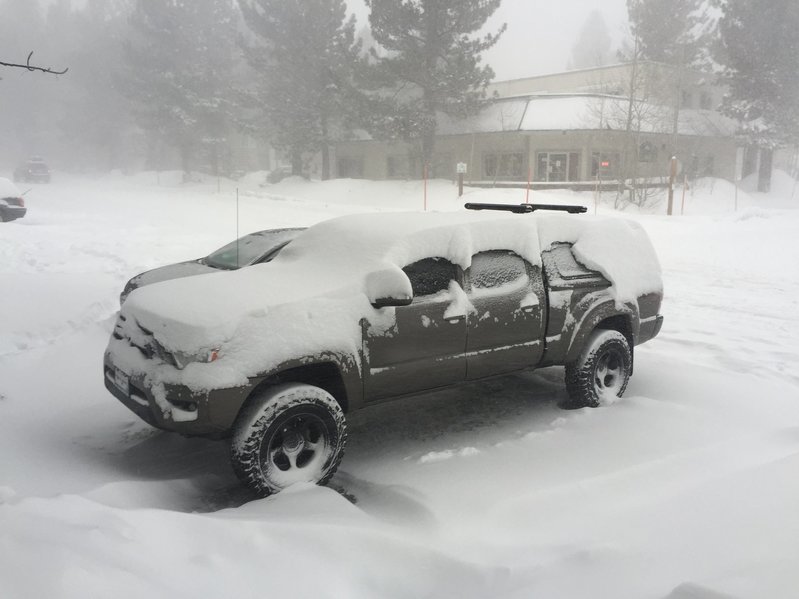

    image.jpg I'm up in Mammoth with a '14 TRD Sport, shoed with BFG A/T KO2s, and have no problems, even though I know others would recommend a different AT tire for the snow. Weight over the rear axle makes a big difference. Snow tires are great and the best in snow but snow melts eventually, unless you want to own 2 sets of wheels/tires you may be able to meet your needs with a more versatile tire is all I'm saying.
