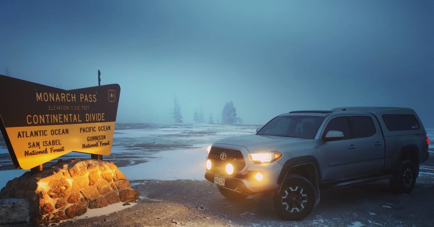

    I do.
    Your MT tires are causing the problem.
    I roll on four dedicated winter Toyo Observe GSI tires from late October though mid April in the high elevations in Colorado’s Rocky Mountains and I do not have any problems like what you are describing.

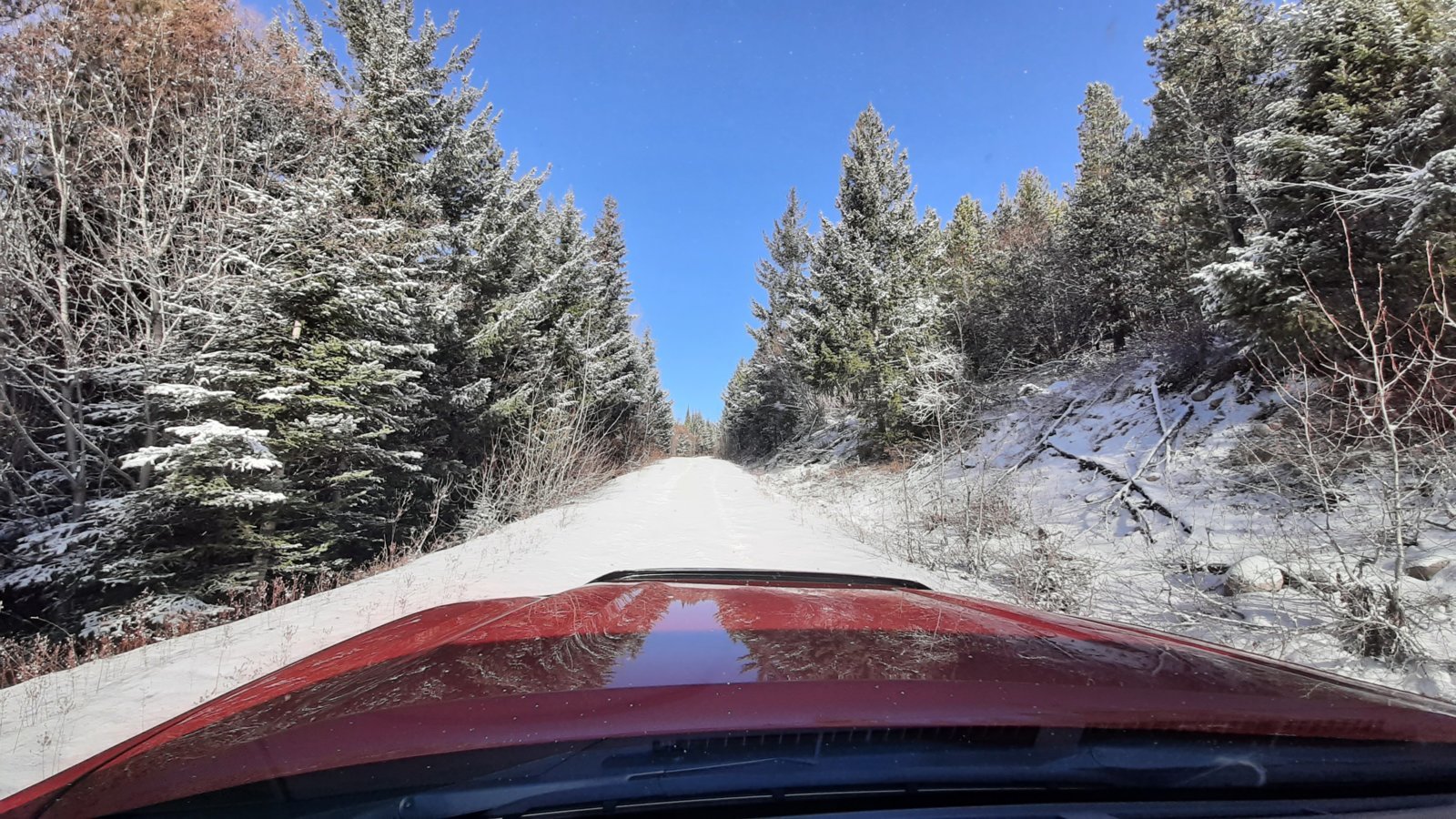

    Yeah those help too. I have no tune, 2016 TRD OR. Just got used to the gear changes and use S mode or ECT if needed. Off road, I am in S mode all day. Never comes out of S mode as the trails are bad and constant up and down needing 1st and 2nd gear.
    On our city streets, we get skating rinks. The type where in a 30mph limit, anything over 10mph puts you in the ditch. Less throttle the better. I will put it in S mode and 5th gear at stops, less chance for tire spin. My last 3 trucks were all manual shift, and in snow I always started in 2nd gear to reduce slip.
    I have used my BFG KO2s in deep mountain snow when it is dry powder, but they are useless on icy streets or wet snow.
    In Calgary I drove winters with no snow tires and rear wheel drive. Flat, no hills, and cold dry and sticky snow. These Tacos not very good for winter ice. Fun for deep mountain dry snow.
    For the bad stuff we take my wifes RAV4, way better traction and much safer.
    My Taco has 500 pounds in the back. No sag as I have rear air bags. Nokian Hakkapellitta LT3 (D load) snow tires.
    This photo. On this trip, I could not get up that little incline in 4wd. Warmed and the snow turned wet. A week before, I went 15 miles up that same trail in 2wd. Any added throttle and get out the shovel and start digging.
    All snow is different. I thought about a tune, but I am old school and only do the bare minimum of mods to my trucks.
