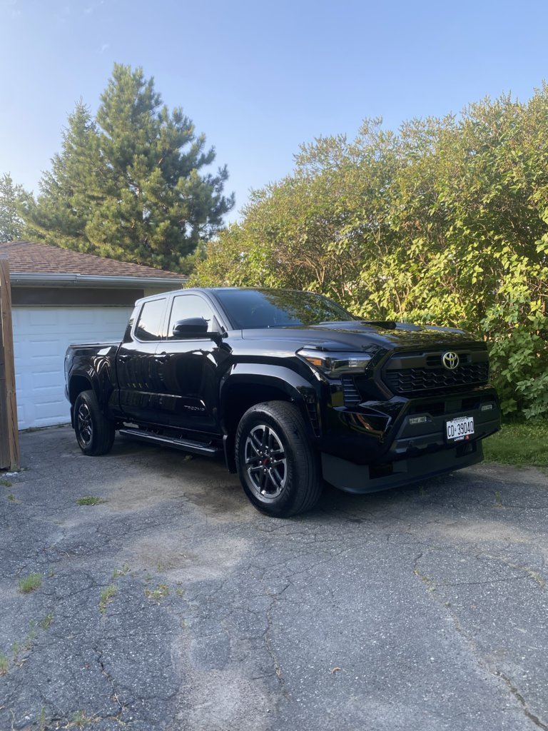

    Hey guys, I live in northern Ontario Canada, we have cold winters here and I spend a lot of time hunting and fishing and being outdoors with my dog.
    I was wondering if anyone could help me figure out what size and type of winter tires I should purchase?
    It’s a 2025 TRD Sport
    Thank you in advance
    ………yes, I know I still need to remove the air dam lol

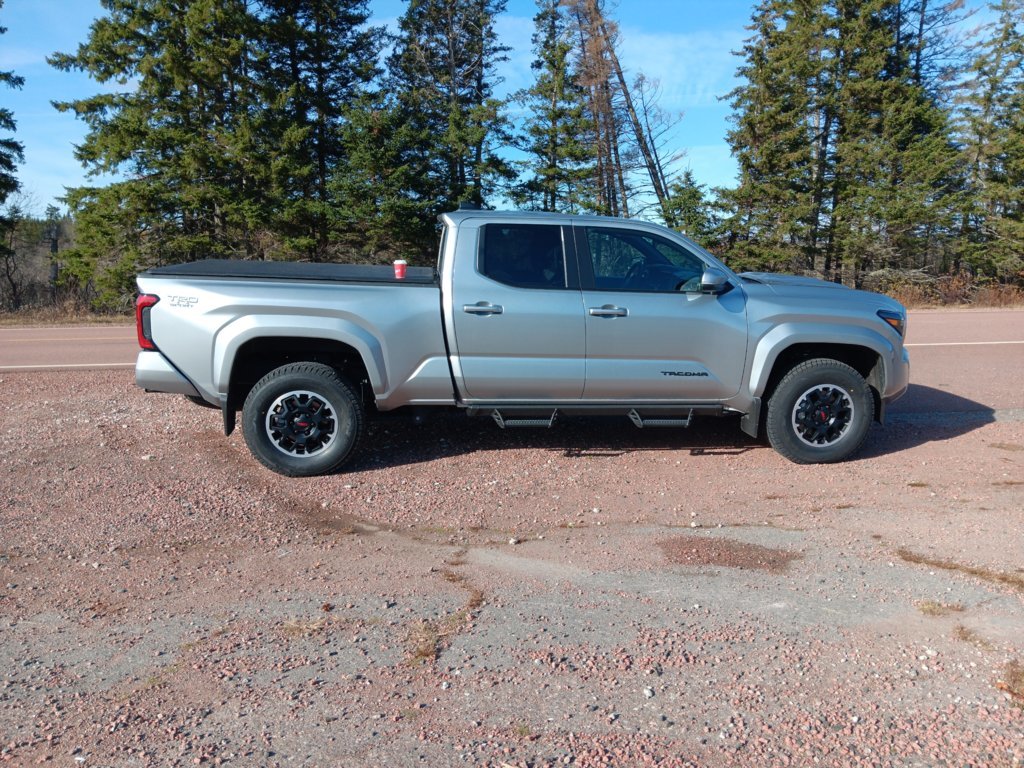

    I found that going from an 18" tire to a 17" tire saved quite a bit of cash at Canadian tire.

    Thank you!
    Beauty Tacoma …..love the timmies cup

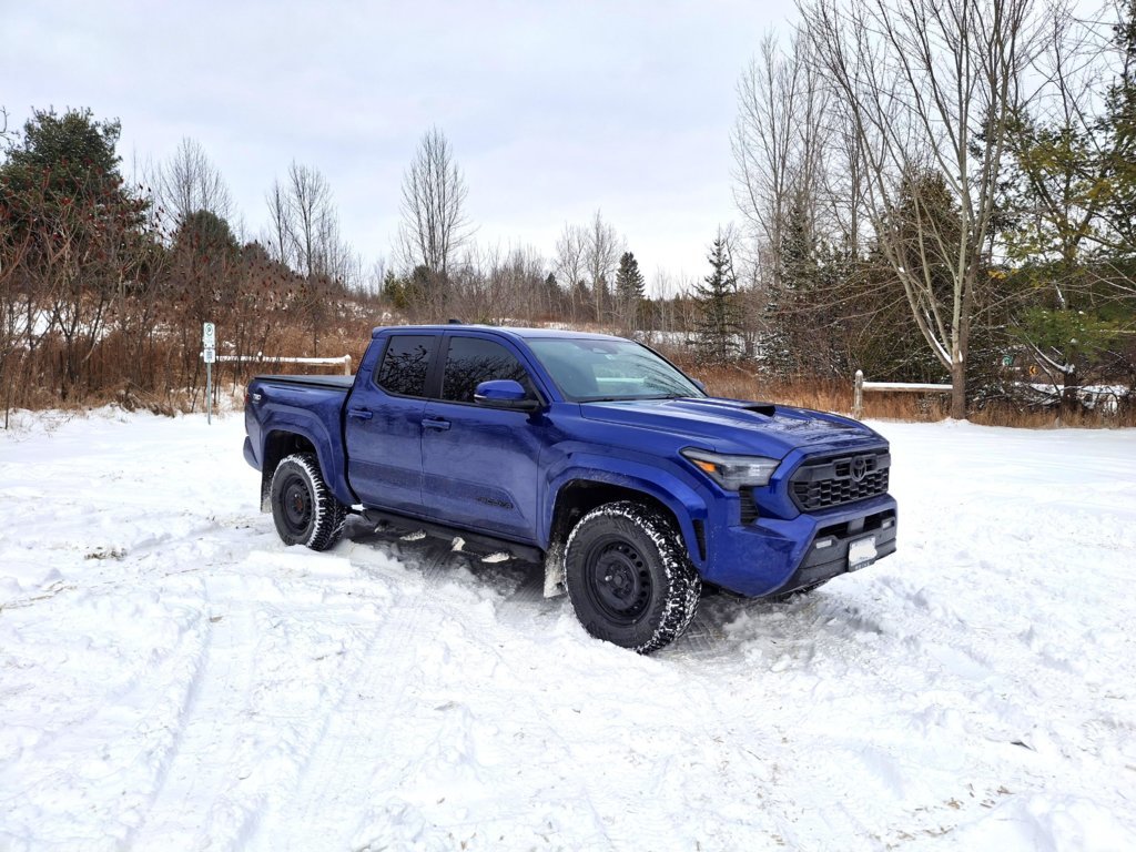

    Nice truck !!!! I bought a set of 17" steel wheels from Toyota and got my tire guy to mount some Nordman North 9 265/70r17. From what he told me, Nordman is a more economical option and it is owned by Nokian - who probably make one of the best winter tires around . They seem pretty good in snow / ice so far . I was a big time Bridgestone Blizzack guy but my tire guy loves the Blizzack but hates how fast they wear. winter photo .jpg
