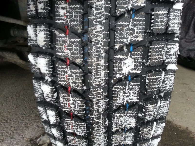

    I run Toyo winters up here. We get lots of ice. Run the GSI-5 the past few winters, my new GSI-6 should be here Friday
