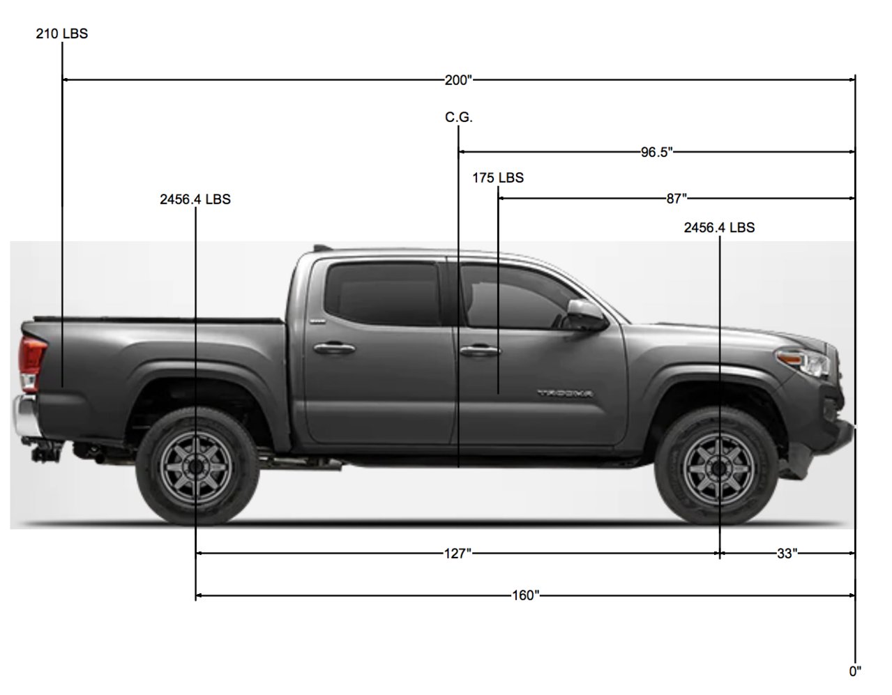

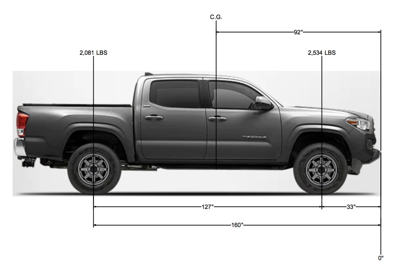

    210 lbs back against the tailgate is what I calculated to get a 50/50 weight distribution.
    Assuming 4,525 lbs curb weight with 56/44% weight distribution (DCSB, according to Motor Trend).
    4525x0.56=2,534 on front axle
    4525x0.44=2,081 on rear axle
    2534x33=83622 front axle moment
    2081x160=332960 rear axle moment
    83622+332960=416582 total moment
    416582/4525=92.06 C of G
    If we want the C.G. centered between the two axles it needs to be at 96.5"
    So with a 175 lbs driver at 87" and a weight (W) at 200":
    (416582+(175x87)+(200xW))/(4525+175+W)=96.5
    (431807+200W)/(4700+W)=96.5
    431807+200W=453550+96.5W
    103.5W=21743
    W=210.08 lbs
    Disclaimer: The distance measurements are estimates scaled off of a photograph, take that for what you will.

    Or 342 lbs if you put it over the axle

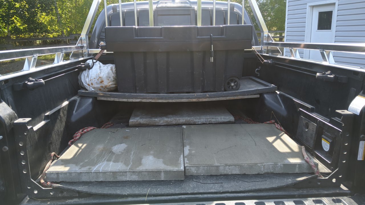

    2 x 2'x2'x2" concrete tiles
    1 x 3'x2'x2" concrete tile
    6 x 40lb sand bags
    tool box ~400lbs, aftermarket front (+winch), rear bumpers and full skids
    all but the sandbags went in today before heading out for a month long job
    keep the weight over the axles as much as you can
    4x4 Dakar HD with airbags, siped Duratracs in central BC
    Drive accordingly
    Sandbags will go under the toolbox between the wheel wells, tire chain are in the sack beside the toolbox.
