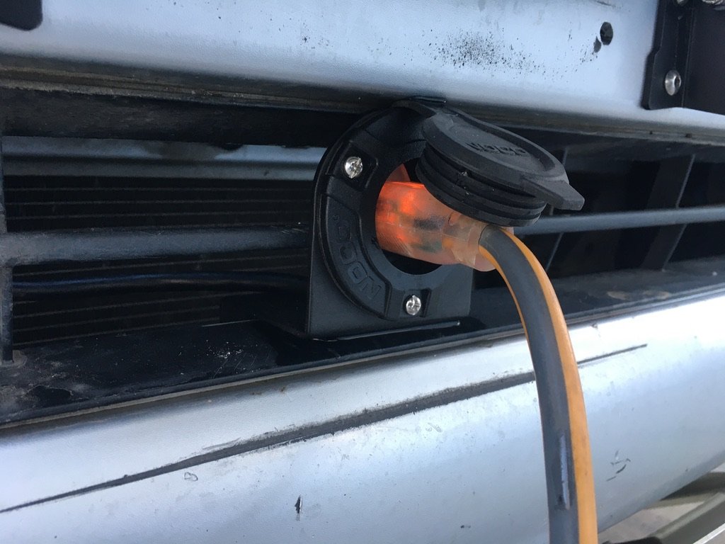

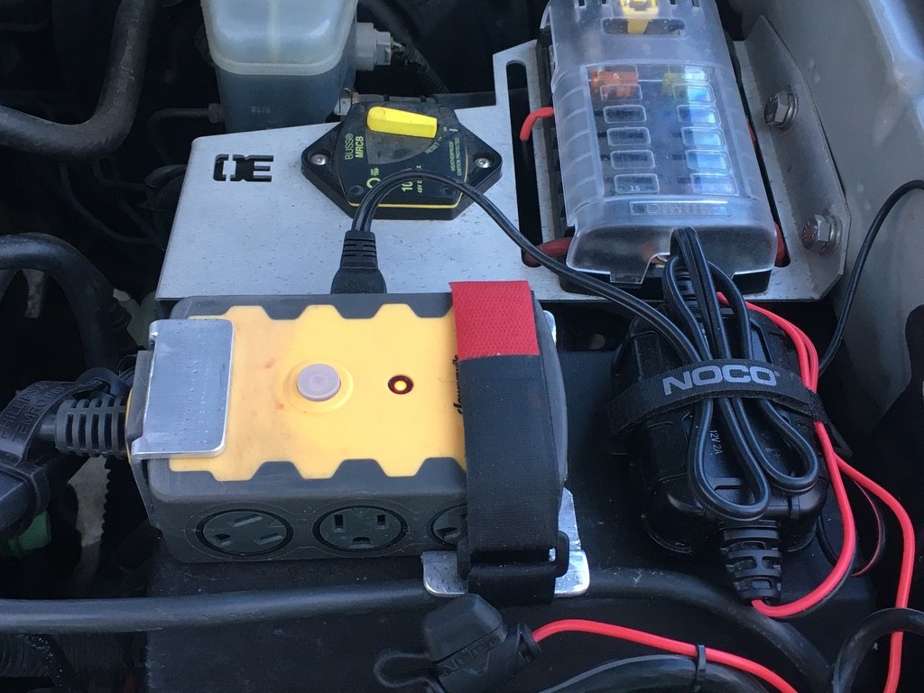

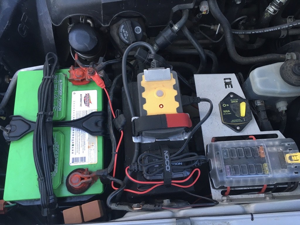

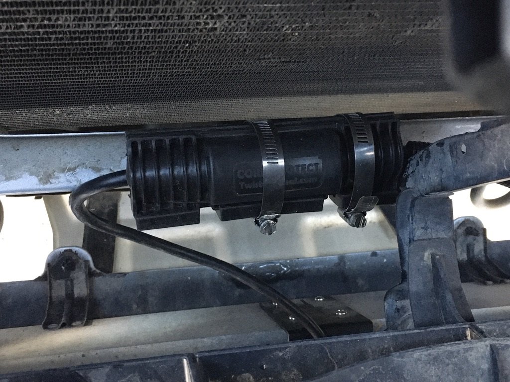

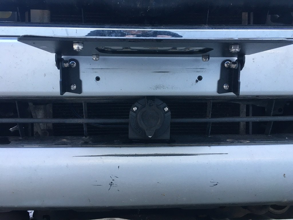

    In an attempt to keep my battery healthy and make startups on cold mornings here in CO a little easier I stole some ideas from this thread: https://www.tacomaworld.com/threads/block-heater.591203/ and cobbled together some parts for a cold weather setup. Items include: Kat's Engine Block Heater KH11813, Kat's 22200 Battery Thermal Wrap, NOCO Genius2D Trickle Charger, NOCO GCP1 15A AC Port Plug, Twist and Seal Cord Protect, Dissent Off-Road Flip-Up License Plate Mount, and an outdoor power strip.
    As noted in other block-heater threads, there is a little filing needed to be done for an accurate fitment of the heater into the block.
    I fabricated an aluminum mount for the power strip and attached it to the cover of the fuse box with machine screws and silicone for sealing.
    For the port plug, I cut out the grille behind the flip up license plate and attached it with a home made bracket to the aluminum crossmember. I connected the port plug to the power strip and protected the connection with the cord protect and strapped everything securely and out of the way.
    Installing the battery wrap was straight forward, and so was mounting the trickle charger. Once everything was mounted, and wires tucked away, I plugged everything into the power strip.
    Now all I have to do when the temps hit rock bottom is run an extension cord to the front of the truck, flip up the license plate and plug it in. This is my first winter with this set-up and my truck starts with ease. No sounds of strain or stress.
