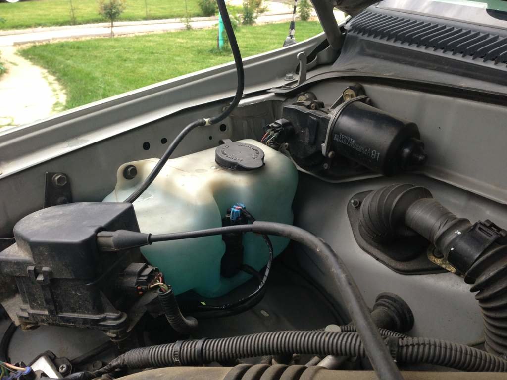

    Just in case anyone's still on the search for a good donor candidate.
    Picked up one from an '89 s10 blazer. Fits like it was made for it. Even used an existing threaded bolt hole. Total cost $12.
    Oh yeah, seemed like any s10 or s10 blazer would work from that era. There were at least 6-8 to choose from at the yard I was at.

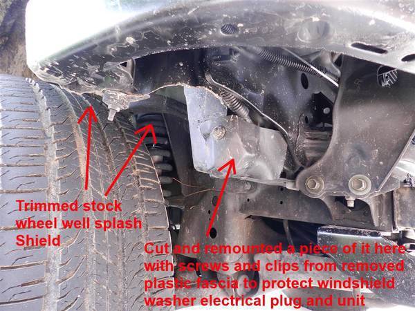

    I used a piece of the plastic lower bumper cover I removed to fab a protector that makes it look better Imo.
