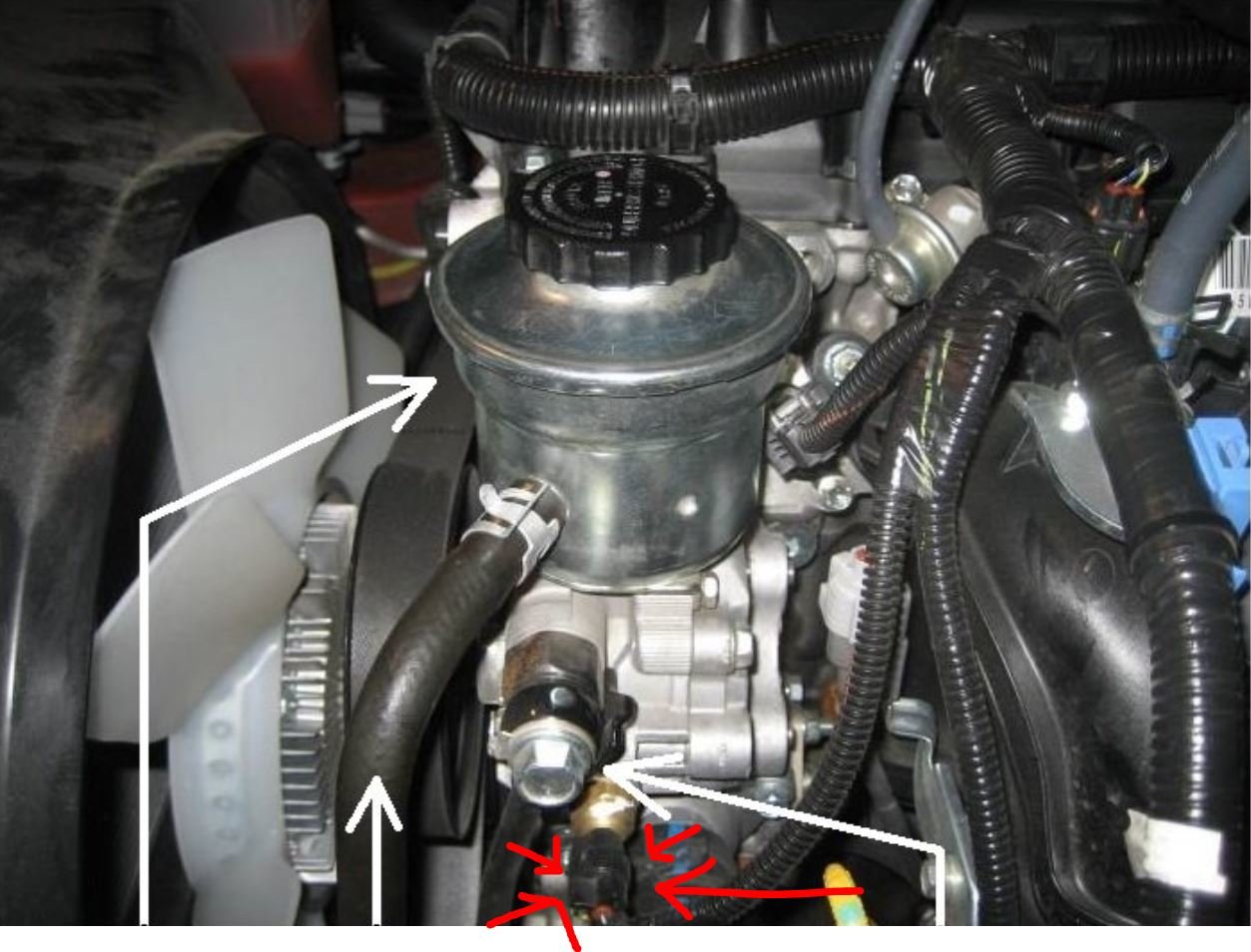

    Hey guys, I have a 1999 3.4 Tacoma and I decided to replace the belts finally. While replacing the power steering belt I noticed the yellow sensor wire on the back of the pump had broken off. I am having trouble finding the connector. I can find the sensor but not other end with the connector.
    So I have 2 questions,
    1. What is this sensor, what have I ruined by running without it for who knows how long?
    2. Where can I get the connector? If I can just strip the yellow wire and solder/crimp a new connector on I will be golden.
    Thanks guys!
    Here is a poor image of what I am talking about (red arrows):

    It is most likely a spade connector inside the plastic plug.
    Just one wire correct?
    A picture of the sensor would be good .

    Should have been more clear. The entire connector is missing. But yes it only has 1 wire.

    It should be a Male spade connector on the sensor.
    Find the right size enough slack to solder to the yellow wire?
    It is the Pressure sensor for the Power Steering Pump sends a signal to the ECM

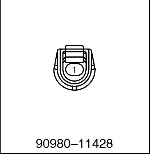

    Does it look like this?
    If so, that's your part number for the connector.
    https://parts.conicellitoyotaofconshohocken.com/oem-parts/toyota-housing-connector-f-9098011428
    You will also need 82998-12440, this is a "repair" wire with terminal attached. You just need to insert this wire into the above connector, then solder the wire to the broken wire on your truck.
    https://parts.conicellitoyotaofconshohocken.com/oem-parts/toyota-terminal-repair-w-w-8299812440

    There you go !!
    That does look like the connector my EWD shows

    Yep that's it. Thank you so much! Just ordered one now.

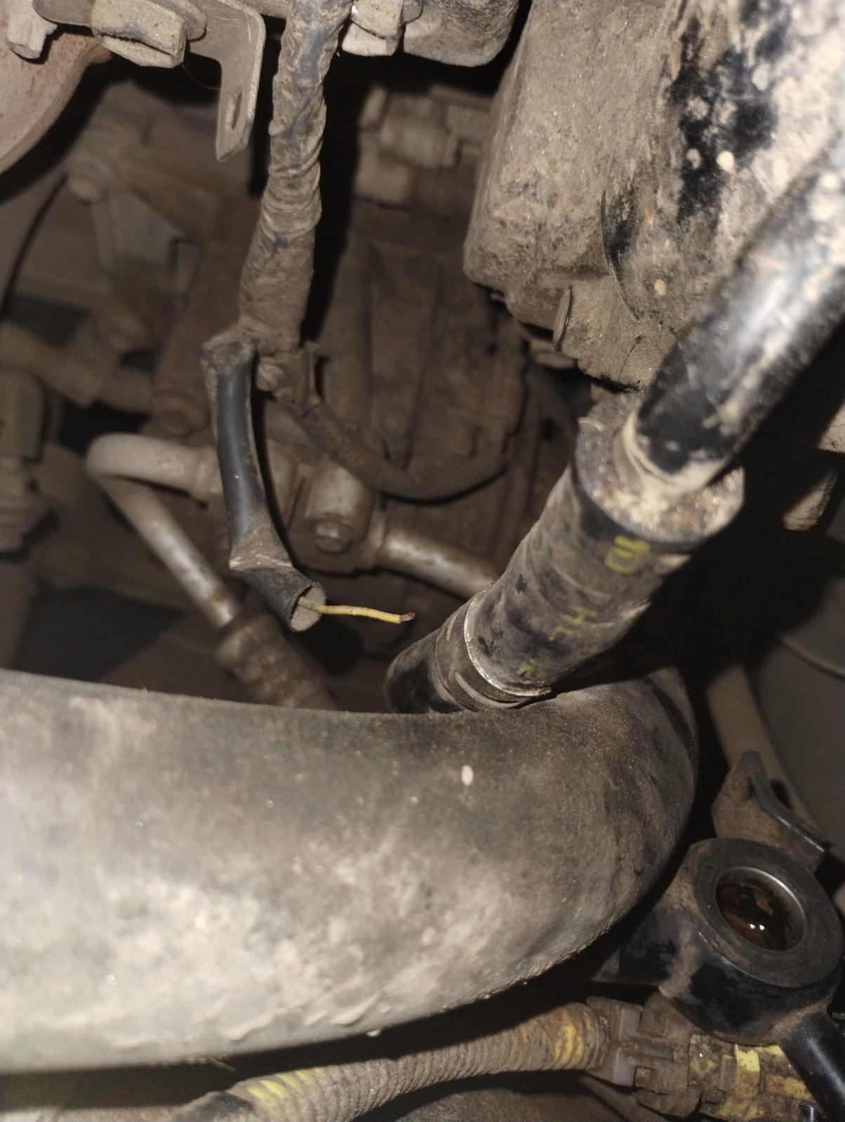

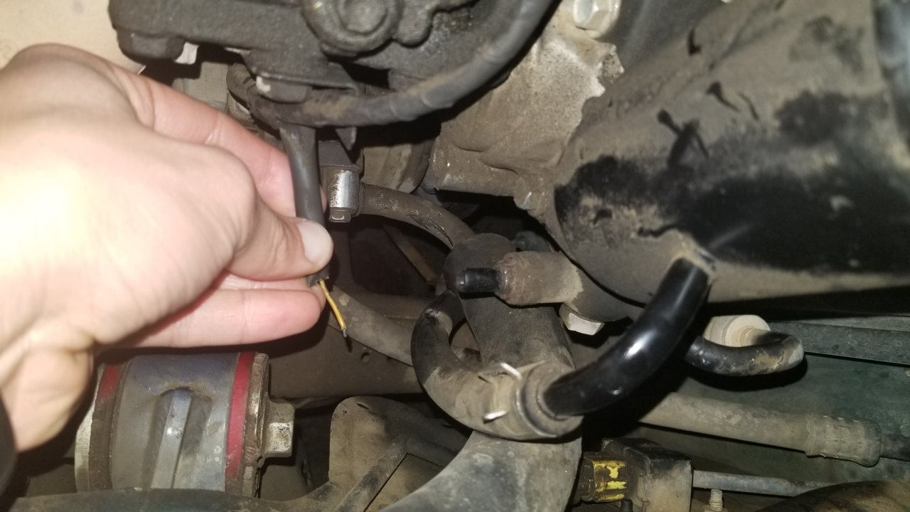

    This is hilarious but I just broke this today...trying to disconnect the sensor to remove the steering line. I came on here to see if anyone also had this problem and to see what people are doing about replacing the $300 pressure line. I tend to pull wires out of connectors a lot so I know the drill - just go buy a pigtail and solder on.
    The best part about this thread is how people are like "I've never seen one connected and the truck runs fine" HAHA. That is why I LOVE this truck. It can have no coolant, no oil, disconnected stuff...and it still won't complain, at least not right away.
