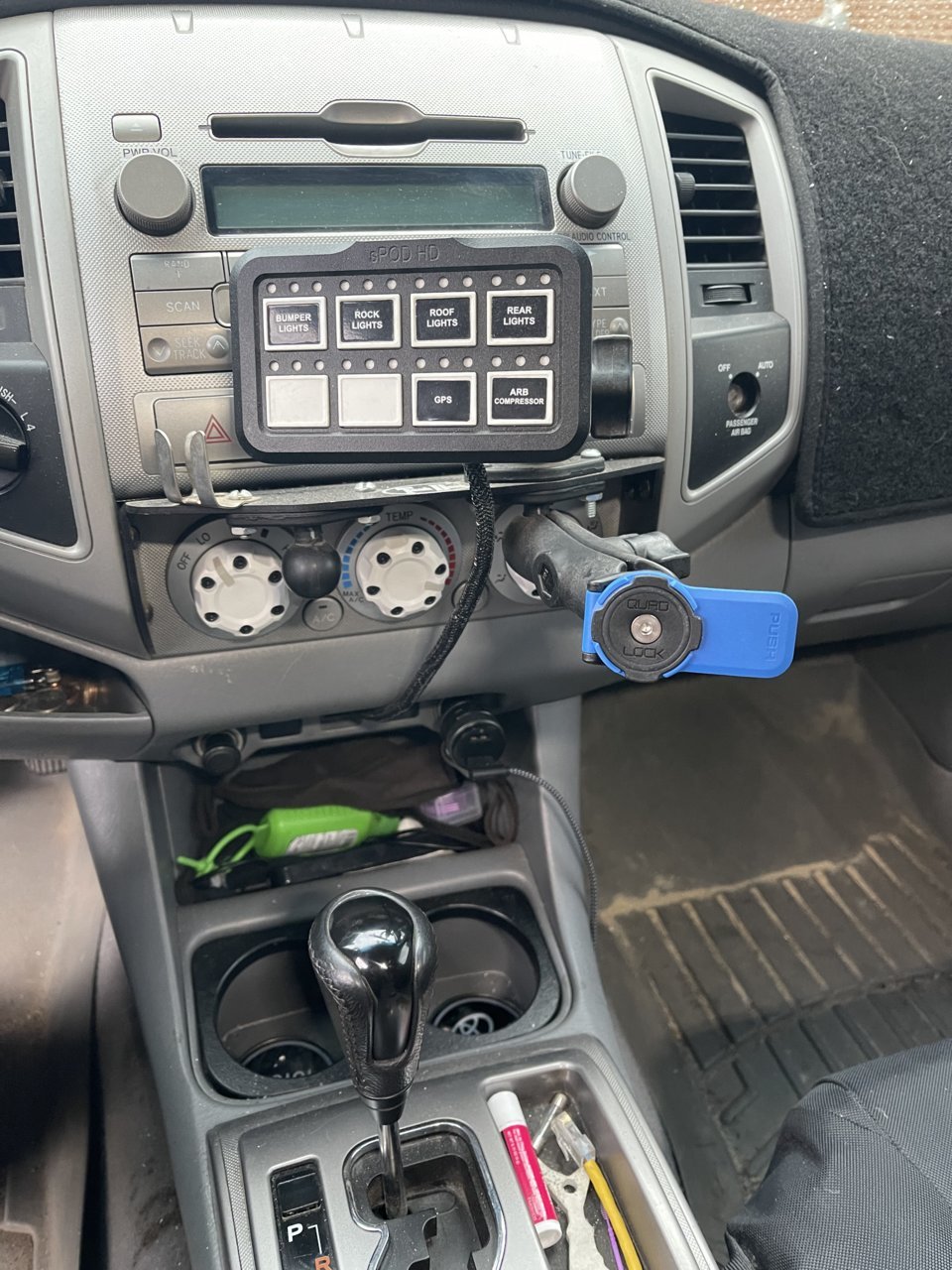

    That I don't know. I dislike wiring, reasoning why I got an sPod. And true, I also have 8 switches, but not all used (and less than in this picture)
