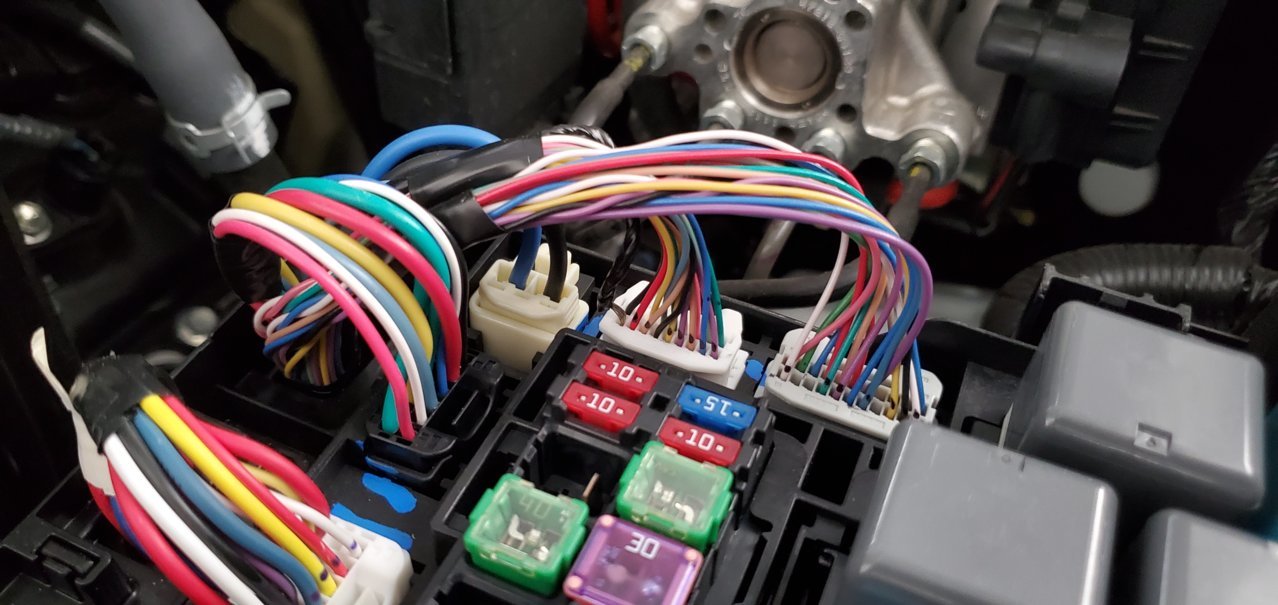

    Hi everyone, I was removing some after market parts that came on my truck and noticed this wire and jumper that looked out of place. Can anyone ID if that exposed wire (black sheathing with random electrical tape) is a factory part or if that was something that was potentially added to the jumper? It also looks out of place past the jumper where it becomes a big thick fat wire almost in some sort of sheathing (whitish/opaque) as opposed to normal wire.20190912_122135.jpg 20190912_122150.jpg

    Not OEM

    Looks factory to me.

    That shouldn't explain that wiring job unless someone really "rigged" it up. From what I see (and your identification of the wire) it looks like a cable I normally use in the industrial field (a signal wire). The wire that you have pointed out looks to be the shield for that cable. We normally wrap that shield in tape to make sure that it doesn't come in contact with other "live" conductors. If my interpretation is correct, there should be two more conductors paired with that wire (in the cable set). Knowing where they go my help too.

    Possible. But even if it's just a shield, I would think that the factory would have used heat-shrink instead of tape.

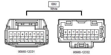

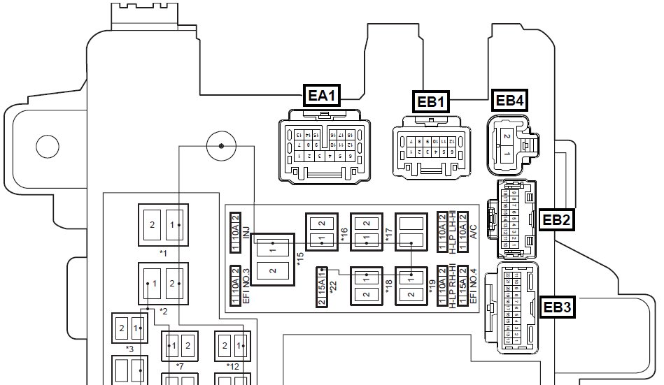

    Interesting. So what is the EB2 connector for? The rest of the pins on that connector look OE?

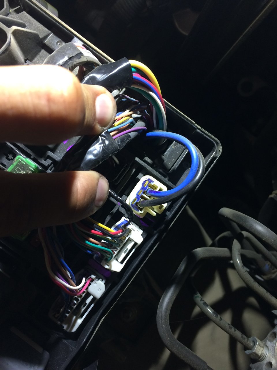

    Confirmed factory wire. /thread

    Interesting that OE used tape instead of shrinky-dink. :)

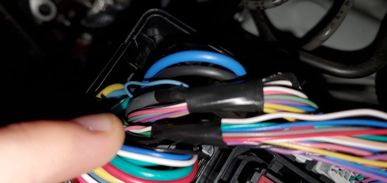

    The gray is a shielded wire (ground) for the rear camera, seems they didn't terminate it at the connector.
    Pin 18....

    Thank you both. Appreciate saving me a trip under the truck later. Just seemed out of place and was the first time I have really examined the fuse box.

    Interesting... I was assuming it had something to do with the 4x4 system because the 2wd I looked at first did not have the wire. Didn't look up the schematic though
