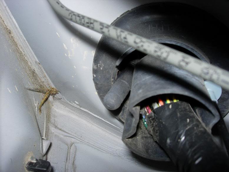

    How is everyone running wire from the engine bay into the cab? Are you following the main wire harness and punching a new hole through the grommet or...?
    I have an idea on how to do this (metal hanger) but wanted to get a few new ideas on how others run wires into the cab.
    Thanks.

    There is a nipple on rubber grommet, to the right of the main harness. I cut the tip and ran the wire through that hole. Its like they left it there just for this purpose. once the tip was removed it was rather easy to push the cable through. Looks like this (disclaimer - this is not my truck or image, I am simple using this as a reference)
