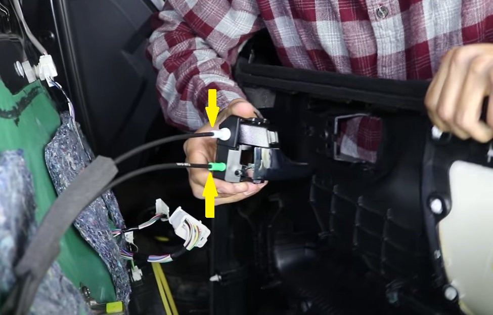

    For clarity then, you reattached these mechanical actuators backwards, you did not wire it backwards?
    door cables.jpgIf this is the case, a lock smith and "slim Jim" may be the best bet to get the door opened again
    I am not sure even removing the seat would give you the necessary access to remove the panel from inside the truck with the door closed.

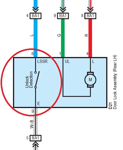

    If it is in fact that, then with someone outside, get inside and lock doors and have the assistant open the door as soon as all are "locked". You'll have a very brief moment since the unlocked sensor will not allow the locked feature.
    Still recommend the 1H connector, it would keep the door on it's own.

    P.S. The power application is brief pulse, so do not keep constant power to the pins on the connector.
