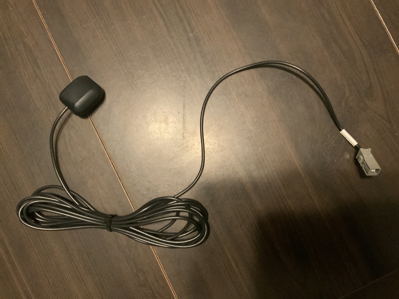

    CarPlay actually uses the vehicle gps. I know because I accidentally connected to the satellite radio antenna instead of gps and it was all over the place.
  7. Feb 28, 2021 at 9:09 PM
    #27
    Shellshock
    Nov 21, 2015
    #170338
    23,470
    Iowa
    This is what came with mine. You are technically supposed to mount it on the dash but it works fine buried under it
