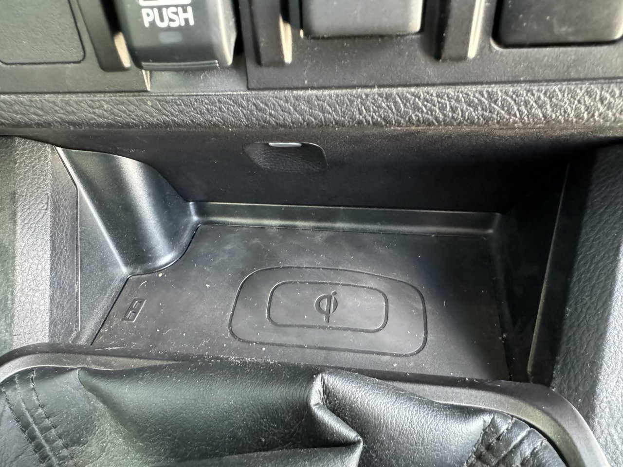

    I’ve got a 2021 with the wireless charger and manual trans console. As many of them do, the wireless charger is bulged pretty significantly. I am aware of the TSB for this, but mine was built more than a year after the TSB so I’m assuming I have the updated parts. Still have the problem, and it makes putting anything in that pocket annoying because stuff will rock around on top of the bulge.
    I don’t ever use the wireless charger and never will (wired CarPlay), so I’m not interested in another charger unless there is one that will stay flat for cheaper than the factory non-charger tray. Has anyone removed this crap and gone with the non wireless charger option instead, just to achieve a reliable flat surface?
    I ordered Toyota part 58810-04020-C0 from BAM Wholesale, which is the tray and console surround for the tray, for a manual transmission 2016-2017 SR w/o the factory wireless charger. That order was cancelled due to back order. Anyone have better ideas? Thanks.

    I was thinking about just cutting the rubber cover off with an exacto blade around the edges and flinging it. Replace with those cheap rubber liners you can get on Amazon. Just never got around to it.

    That’s not a bad idea. Mine came with some aftermarket liners, so I could probably slice it and try it out and throw the liner back in. At least that method is free and if it’s ugly, the liner I already have covers it.

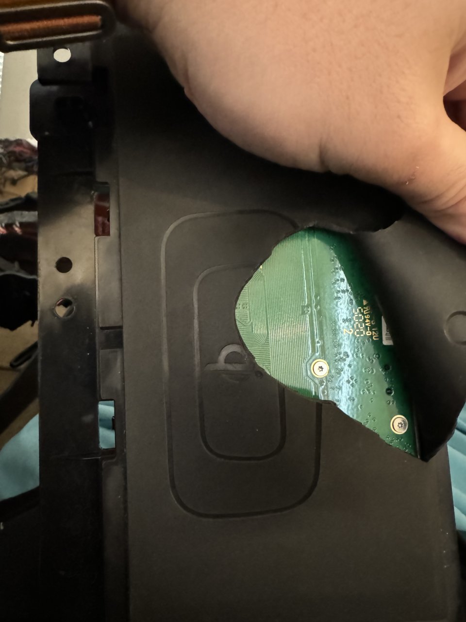

    Confirmed I have the TSB part, which is 861C0-04010. The part the TSB was meant to replace and fix was 861C4-04010.
    I started dismantling my charger by tearing/cutting the rubber off, and exposed a green circuit board immediately below the rubber. I think I’m going to attempt to buy the non wireless charging tray and front console half elsewhere rather than run this without the rubber. It would obviously be fine if I left everything unplugged (which I will), but it’s a little bit tacky.
    So, I’m going to try to order 58810-04020-C0 from somewhere else or see if maybe a junkyard has it on car-part.

    Are you going to fully dismantle that? I'm curious how the rubber is secured along the edges. I would think there has to be some way to either replace the rubber piece or reposition it so it's flat again.

    Yeah, so you have the front console piece that the rear console clips into. The front console piece clips into the dash. There is an adapter plastic piece that screws to the front console. That whole thing can come out. That has the rubber pad (basically a cover) glued to it. The wireless charging module itself fastens up to the bottom of that adapter and butts up to the rubber layer (the one that warps).
    To replace the rubber is to buy the simple factory $50 part, which is the adapter plastic piece. You would move the old wireless charger module and its associated wiring over to the new adapter that has the new rubber layer, and then install that assembly into the old front console half.
    The reason I don’t want to buy a new adapter piece with the rubber layer is that it’s just going to do the same thing over time. I believe over time the rubber warps from heat and expands, becoming too big for the hole it’s glued to. Therefore it heaves upwards and forms the mound or bulge.
    for that reason I think I’m just gonna buy the non Wireless charger front console half and pocket for $100 and call it done. I believe the new pocket would be all plastic and whether or not it becomes useful, it would at least not bulge and become tacky.

    I think that’s the best move to satisfy my annoyance with the bulge without spending too much money or time. The non charger tray actually has a slant to it which I think would be nice to dump my phone down into when plugged into CarPlay.

    That's what I'm trying to figure out. How to replace JUST the rubber layer without buying anything. Since it's glued down, a heat gun would make quick work of that. Something has to be holding it along the edges. I wouldn't replace it with the garbage rubber Toyota used but something a little more rigid that couldn't bubble up. All of my wireless chargers use thin plastic, not rubber. At the very least, you could cut away all of the rubber and cut a this piece of plastic to fit where the rubber is without tearing it apart.
