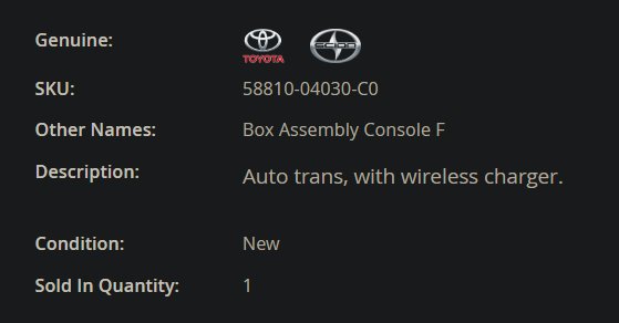

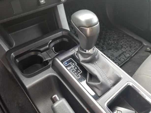

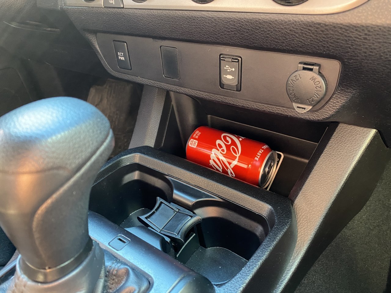

    I was able to find 2 pictures posted by someone on here.
    Main thing is that you buy the correct one for your transmission:
    58810-04020-C0 - Manual w/o wireless charger
    58810-04010-C0 - Automatic w/o wireless charger
    I believe the trays themselves are the same auto or manual, but they come with the front console half and that is transmission specific.
    I’m not sure if the console halves are different between wireless charger or non, that’s a comparison I’ll have to make after I receive mine. I placed the order at a different place now.

    Just a heads up but when I look up the part number it says WITH wireless charger:
  14. Oct 1, 2023 at 3:40 PM
    #34
    BLtheP
    BLtheP [OP] Constantly Tinkering Member
    Apr 5, 2022
    #394355
    4,657
    Plano, TX
    2021 MGM TRD On-Road DCSB MT
    RC60F Transmission ADD delete with FJ full-time tube FJ Metal Clutch Pedal OEM Mexico-Spec Condenser Fan 265/70R16 Michelin Defender LTX M/S 2 OEM 1-Piece Lug Nuts Custom Built Switch Panel for all Electrical Accessories Rigid Amber Pro D-SS Ditch Lights Rigid 30" SAE High Beam Driving Light Bar Rigid SR-Q Pro Back-Up Light Kit (Recessed) VLEDS Tail Conversion VLEDS Foot Well Light Kit KC HiLites Cyclone V2 Under Hood Lights Operable (Switched) Clutch Safety Bypass
    Whoops, that should have been 58810-04010-C0. I’ll edit the post.
