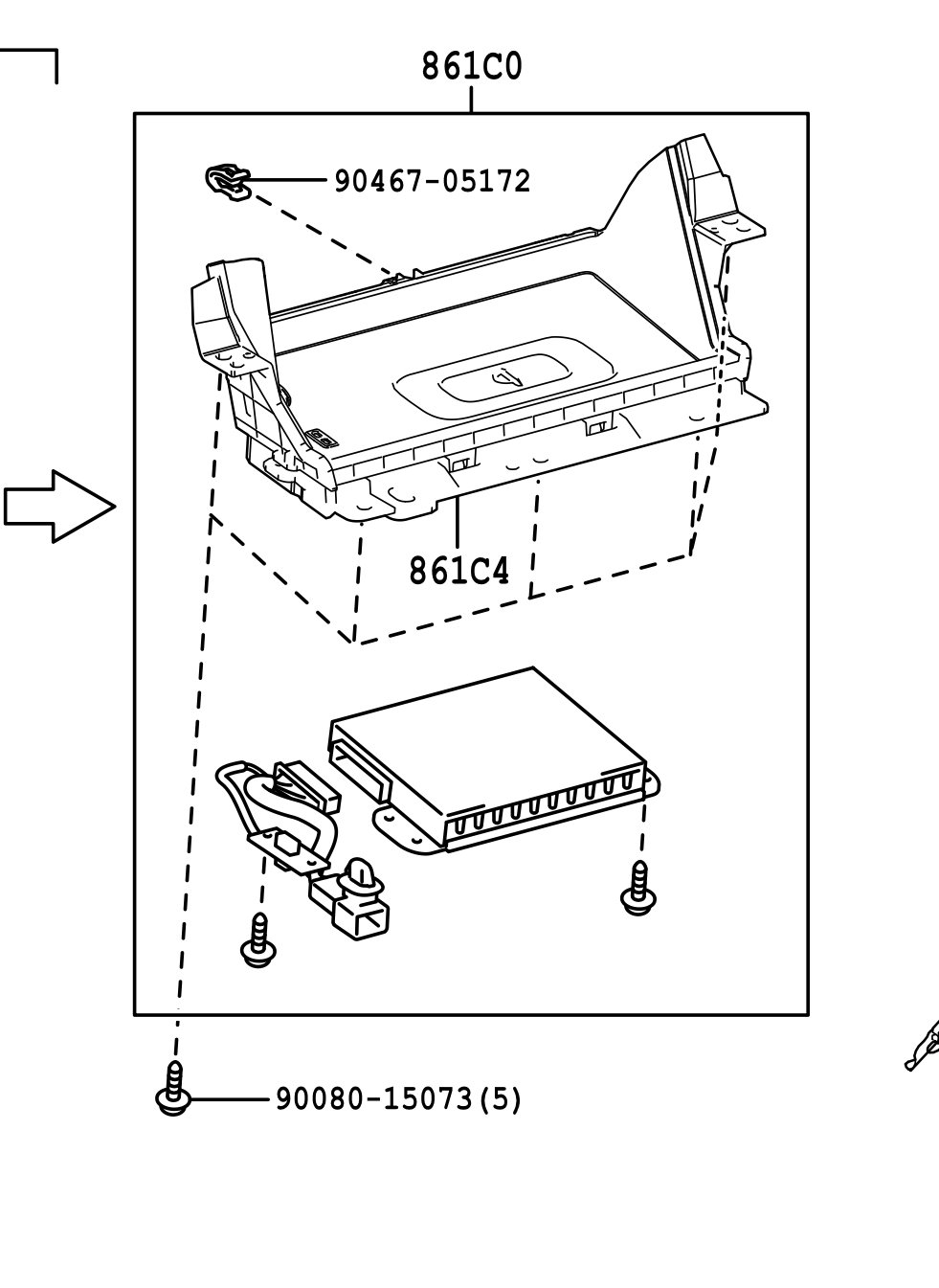

    OK - so I think I got a bit mixed up on the TSB. I mentioned I had the TSB parts because when I pulled my charger out, it had the sticker on it that says 861C0-04010, and that part is mentioned in the TSB. So I thought I had the updated part. Looking closer at the verbiage, and some parts diagrams, it appears 861C0 is the assembly (tray + charger/wiring). It looks like 861C4-04010 is the tray itself, and is the tray you get if the TSB is performed.
    What I don’t understand, is why the TSB came out in November 2019, and a 2021 has the issue (actually seemingly more 2020+ have the issue without using the charger, than earlier trucks). I am tempted to buy the 861C4 part for $40 and see if it fixes the problem.
    On the flip side, I started thinking about it and I can buy the automatic transmission front console and just use the tray with my existing front console. The front console kit comes with the console half and the tray, so it’s a bit wasteful still, but the trays are all the same. Only the front console itself is different. So I could buy that kit and then discard the front console half. This would get me the non-charger tray version.
    So it’s between that and the $40 TSB tray for me. I just wish I knew the $40 TSB tray would actually fix the problem. For all I know, that’s the tray I already have and I’d just be buying more of the same crap. There were no part numbers on my tray, only on the assembly sticker (861C0).

    all the TSB does is replace like with like to get through the warranty period. Separate thread on here where people have the new one bubble up too.

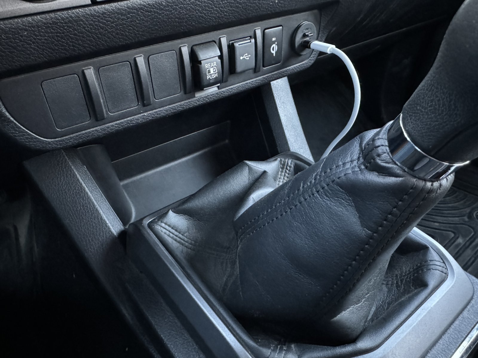

    Figured I should update my thread. At first, I placed the order for 58810-04020-C0. Then I heard that that part is hard to get and back ordered and possibly not in production anymore. The reason being that I don’t think Toyota makes anymore manual transmission trucks that don’t have the wireless charger.
    I did a bit more digging and decided to go with the automatic transmission version of the non wireless charger front console half & tray. The trays themselves are the same across all models (non charger vs charger of course are different), but basically the transmission doesn’t matter for the tray itself. The tray bolts down the same, it’s the front console half that is transmission specific.
    O didn’t need the new console half, so I bought the 58810-04010-C0 auto trans non charger version and just moved the tray over to my existing console half.
    Overall looks good, and I actually like this pocket. It probably has slightly less usable space than the charger model but I like the depth and angle. It works well as a bin for me to empty my pockets into on a long trip. I keep AirPods, a non truck key ring, and sometimes a wallet in my left pocket which is bulky. Nice to empty my pockets and throw all the crap in that bin. Just used it on a 4 hour road trip yesterday and works well.
    Hope this helps anyone looking to delete their bubbly charger. It solves my problem adequately.
