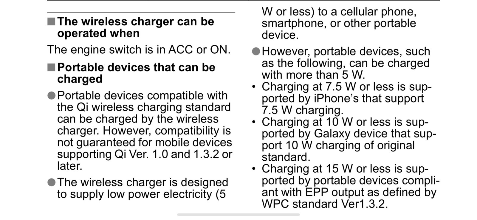

    See charge rates from Toyota, keep in mind that the iPhone 15 is capable of charging at 15W via Qi 2.0 certification and 30W via USB-C, but it appears Toyota wireless charger caps the iPhone at 7.5W (or less) Qi 1.0 standard. The note below makes it unclear what Qi standard the charger is actually using.
    The charging settings of the phone may also be dictating when / how the phone charges. Just because the phone is on the plate, doesn’t mean the OS will allow a charge. The plate may or may not indicate this. Charging is also slowed past 80% by design.
    https://support.apple.com/en-us/108055
    The wireless charger is also more than a static plate. Your phone must be in the center of the charge plate for optimal transfer. As far as I can tell, the charging coil moves up / down in the center of the plate when a device is detected in order to align with the phone coil. The charge plate may go into protection mode if it detects a metallic item that is not a charge coil.
    Cellular data for maps / audio / video / background tasks can put a large toll on power usage, especially if signal is weak. Putting the phone in Low Power mode may help cut down on background task power usage while in the vehicle. Settings > Battery will clue you into the most power hungry apps you are running by % battery used.
