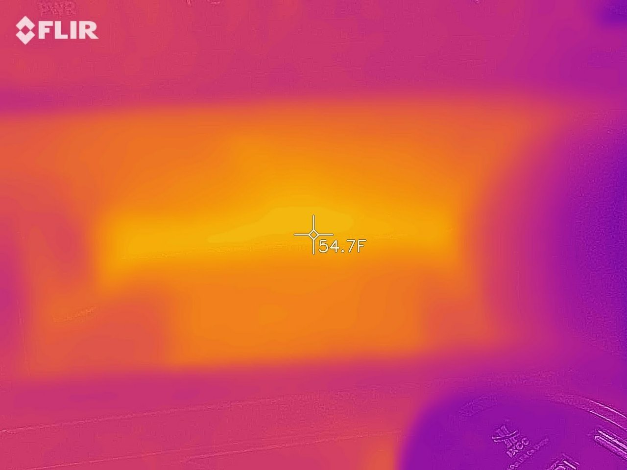

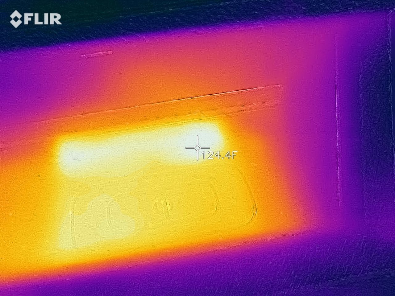

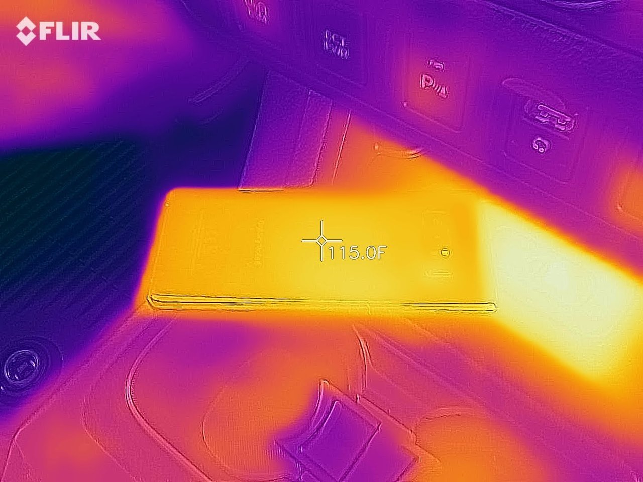

    Sorry to dig up an old thread, didn't want to create a new one for the same issue. Just purchased a 17 with wireless charging, and I have the overheating issue, both lights blink and the phone/pad are extremely warm. Drive home from the dealership is when I first noticed an issue, both lights blinking and an audible beeping. Didn't have the flir with at the time and don't want to decrease the life of my battery by getting it that again. But here's what I found.
    Have tried 2 different Samsung Note 8's, no case or screen protector.
    Here is a picture before I started charging ...
    Here is a photo after 45min of charging with the auto temp controls set to 72deg and the outside temp 30deg ...
    And the temp of the phone ...
    Disappointed in the Qi and the painfully slow charge rate of the USB. Not a huge deal, but having to keep another accessory in the truck to charge devices isn't ideal.

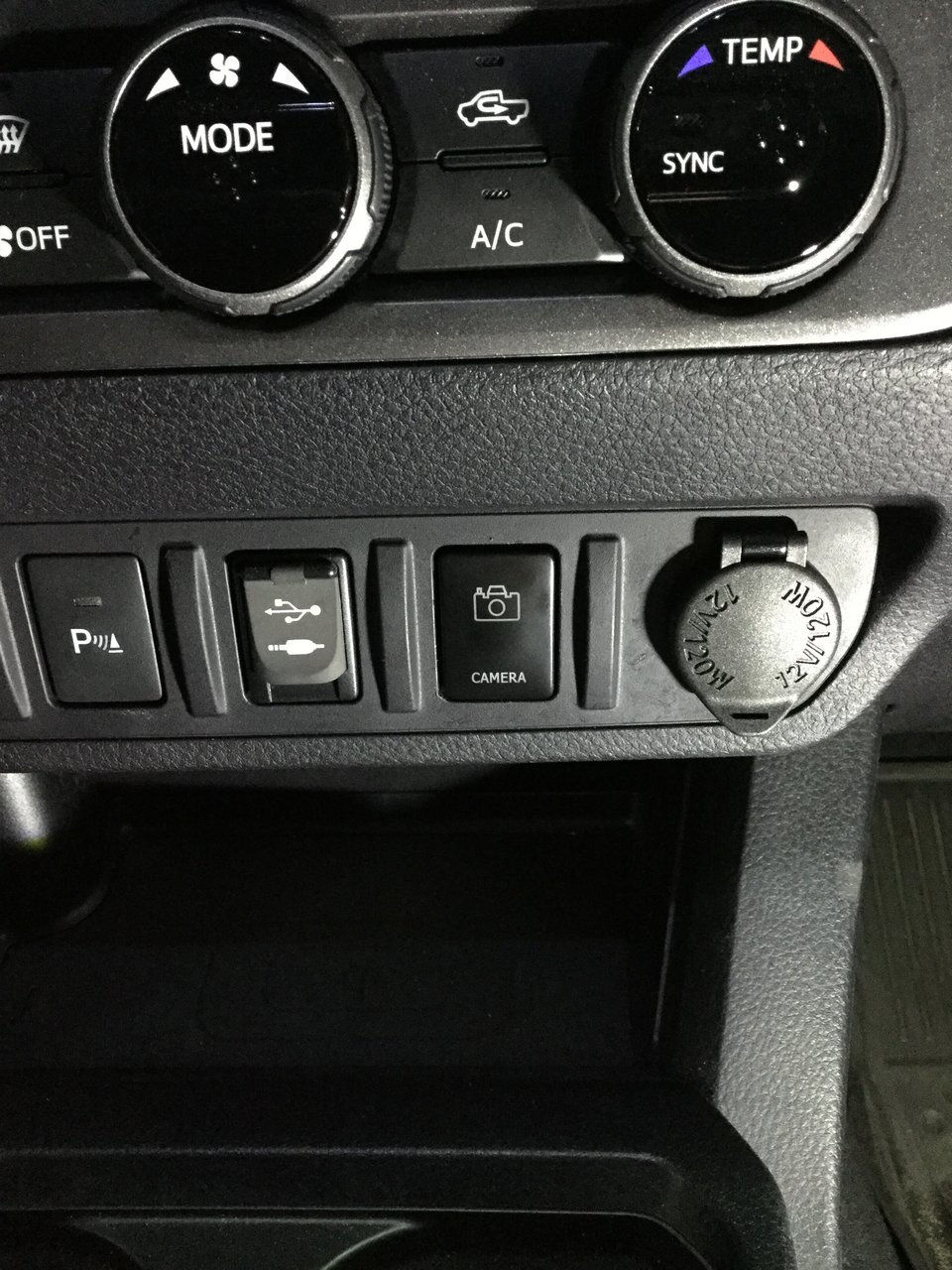

    Yup, charger was worthless, gave the switch away and put in the switch for the front camera.41B757D1-51F2-4F90-91E4-BB368AF740B1.jpg
