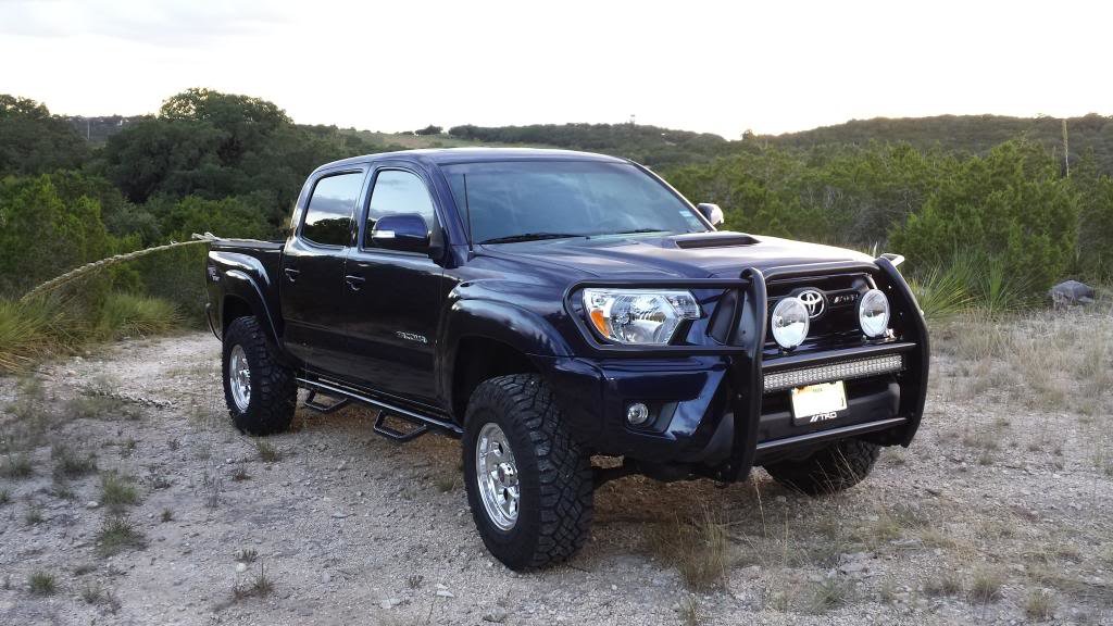

    265/75/16 S/T Maxx 16X8.5 Level 8 Trackers 5100 1.75 HID, LED interior, 3" N-Fab step bars
    My 2 cents:
    We used to run KC & similar incandescent lights in the 80s/90s on our hunting trucks. While they throw real far, they use a ton of power and the bulbs burn out and break often (so always have spares bulbs & fuses!)
    While the advice above is a great solution. If you are not an expert at wiring. Just run 1 relay/1switch for 2 lights. I used to run the 2 inside lights together and the 2 outside lights. So yes, running 2 switches/harnesses will be the simplest solution.
    Also, I remember buying 130W KCs and when the bulbs burned out..had a hard time find the 130w replacements...turns out the 100W bulbs were just as bright and you couldn't notice the difference.
    A LED light bar is the way to go these days...barely use any power, bulbs will never break or burn out. I prefer my LED light bar to my HID 700FF Hellas.
