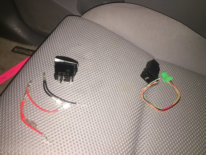

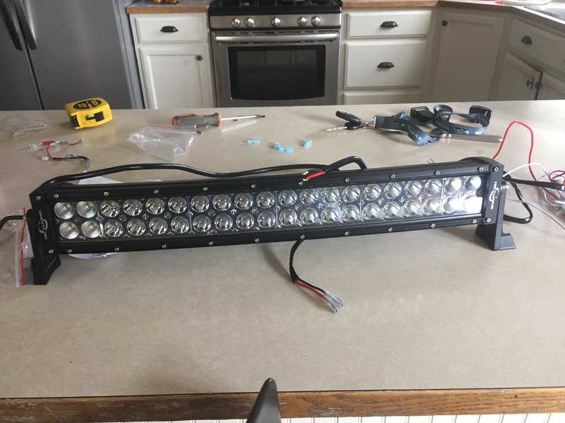

    Okay so I've a got a 20 inch curved mic tuning light bar, I'm pretty sure I know how to wire the light to the battery and all that but where I'm confused on is the switch. What came with the bar is the one that has the four metal prongs on the end and doesn't fit inside me oem spaces while I order the longer switch that is mic tuning and it fits but idk how to wire that to my light bar and also where I'm going to put the switch as all my spaces are filled up? Any help would be greatly appreciated!

    Here are the wire calls outs for the Mic Tuning switch:
    Green wire is fused power to either an accessory or constant power source.
    Red 1 (next to green) to relay outputs.
    Red 2 is connected to the dimmer switch in your cab. This is optional. I
    Black is ground
    Hope this helps.

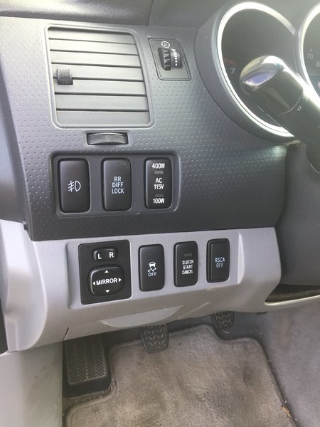

    Defiantly! just need to figure out where to put it now:confused:

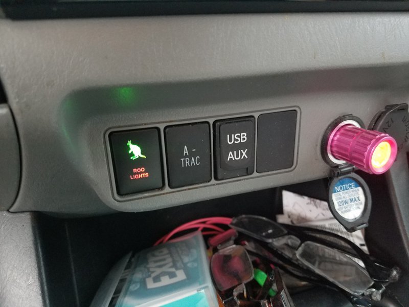

    What do your center switches below the AC controls look like? If you have a blank there AOB makes the perfect switch. I had your problem with the off road buttons taking all the available slots.

    Yeah I've got an open spot down there like you, might have to roll with that, and diggin' the truck man!
