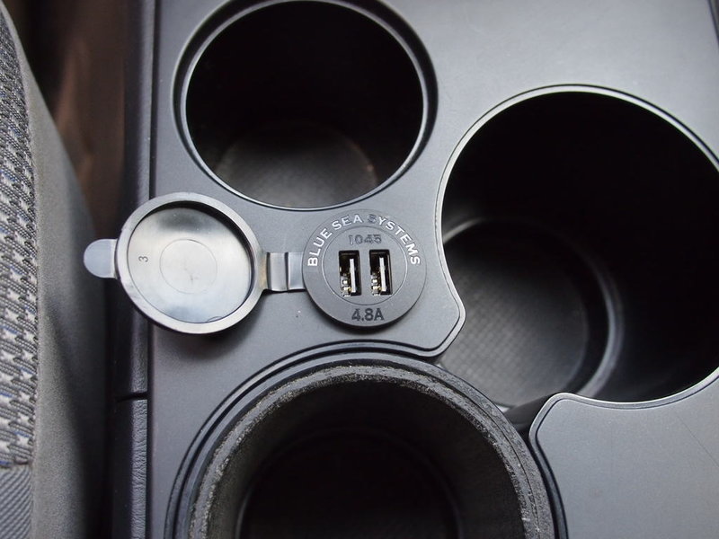

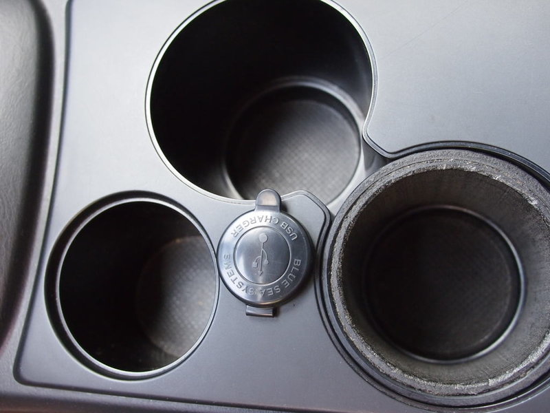

    Installed! I put it here...
    I used a 5A fuse, should be just good enough I hope.
