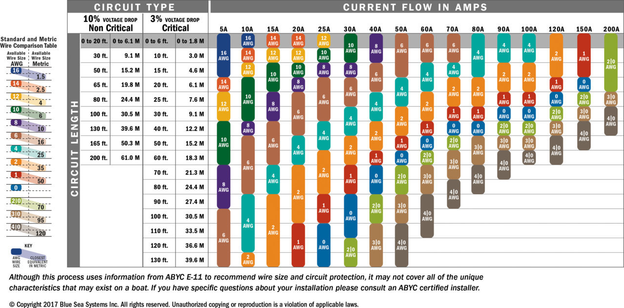

    This if from Blue Sea so it's intended for 12v DC wiring good rule of thumb here. It illustrates the importance of wire guage and gauge for the length of the circuit run.
    Also it's a great idea to have a fuse or breaker within 12" of the battery so a dead short from chaffing or such doesn't burn your truck down.
