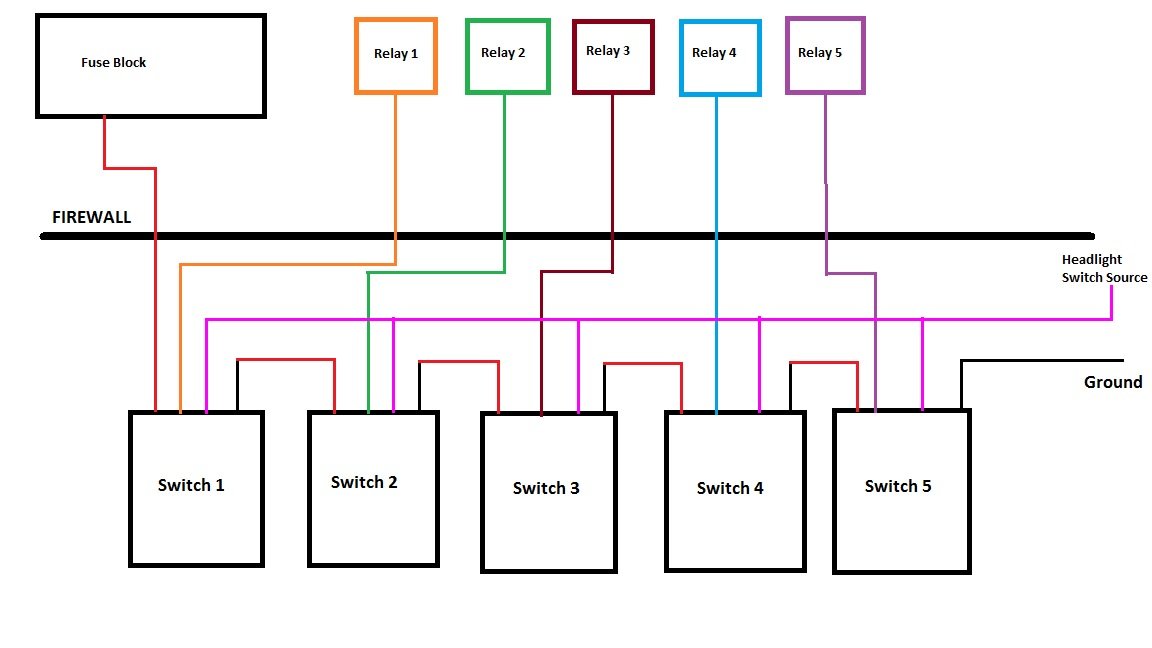

    I know this thread is fairly inactive now but I made some diagrams of the Fuse Box set up and switch panel set up that I think look fairly clean and are easy to follow. Let me know if anything is out of place! Hope this helps some people!
    Moonkonchoe, PilotMM, Snowmad and 9 others like this.

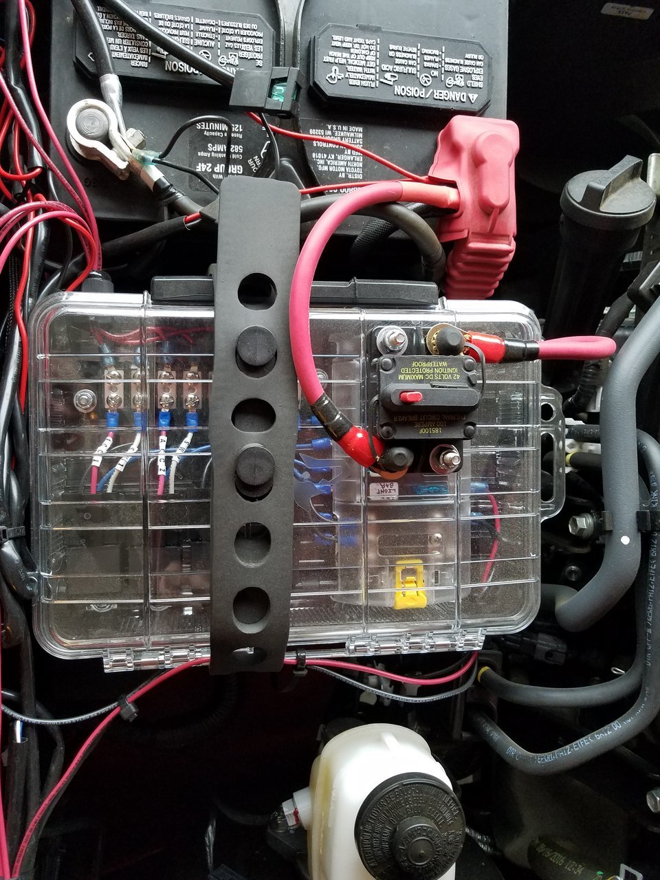

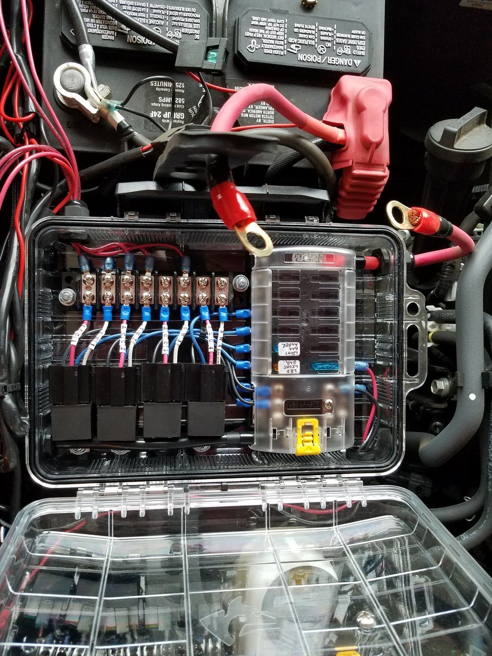

    Here's the best way I have found works great to hold and there's no cutting any wires
    Boghog1 likes this.

    cool stickers and a baseball card With clothes pin, sounds awesome ! wicked
    I notice your switch wiring diagram -- power/ground are in series , is there an advantage to this as apposed to being in parallel
    (I'm a noob to this)

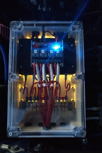

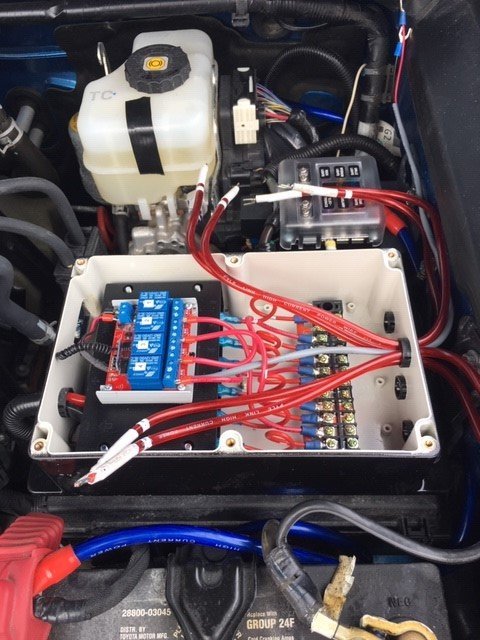

    Just finished building this project box. It consists of a 6x sealed relay with soft touch control pad inside cab as well as a parallel 4 x relay that is wirelessly controlled up to about 75' away from vehicle.
    Littles, jjcheech and nevadabugle[OP] like this.

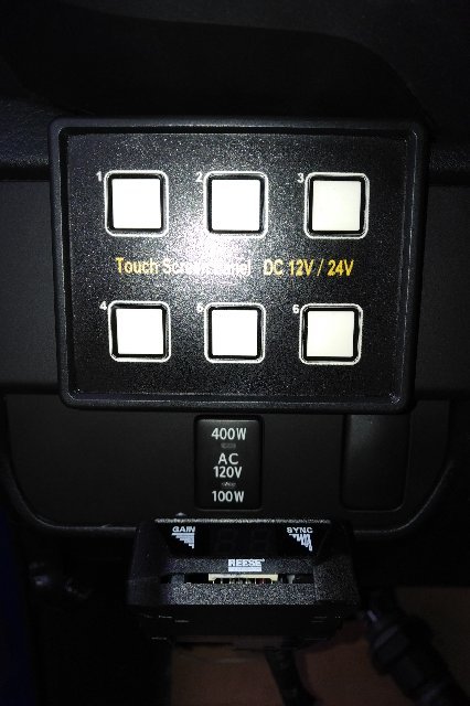

    If your looking for a very clean switch controller have a look at this unit. I just installed in my 2017 Tacoma. It only uses 1 small VGA cable(15 pin wire) that passes through the firewall.
    https://www.amazon.com/Amarine-Capacitive-Touch-Sensitive-Circuit-Control/dp/B01FJ5DL2E

    I would assume you drilled a few holes in the bottom like I did, in case there is some water that gets in. I don't know if there would be much condensation under there since it is sitting right beside a hot engine.
