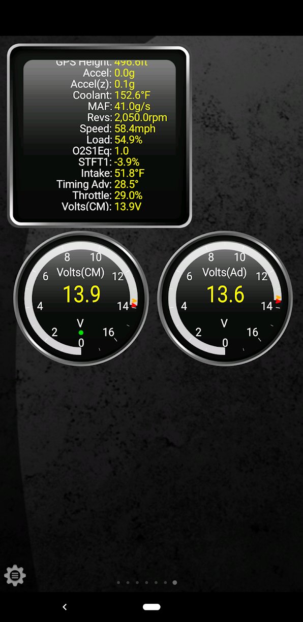

    Just a note that I am using 13.3V in my calcs. Going with 14V will give you more cushion, but I've found the truck oddly charges not much above battery voltage:

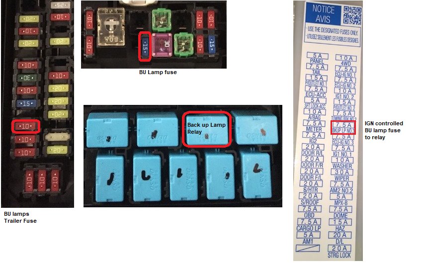

  18. Dec 15, 2018 at 5:12 PM
    #18
    caribe makaira
    caribe makaira Well-Known Member
    Feb 13, 2011
    #51121
    10,438
    Caribbean, Puerto Rico
    05 PreRunner TRD Offroad AutoTrans
    Hood Struts, My version Fogs always ON, Map & Overhead Light Mod,
    3rd Gen trucks have there own 15 amp fuse and relay for the BU lamps/circuit, unlike the 2nd Gen which has a multi-shared 10 amp fuse.(some +12 have a separate fuse n relay for the tow connector for BU lamps)
