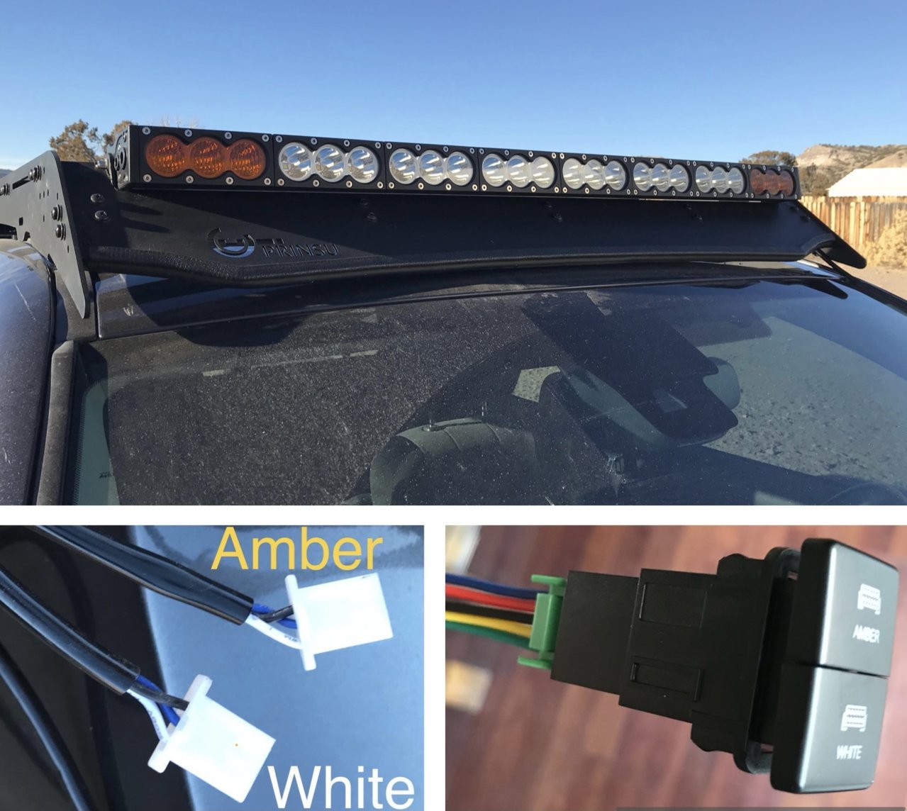

    Searched elsewhere but found no answers. I’m an electrical newbie.
    I recently, off Craigslist, acquired a prinsu rack with a 42” cali raised dual function light bar (amber/white). Dude who sold it included a wiring harness with two leads for non-oem style switches for each color - different from current Cali raised dual harness which has one lead for one switch with two buttons for amber/white.
    I ordered the Cali raised dual function switch thinking it would be an easy job. But I don’t know how to wire this switch (blue/red/black/yellow/green) to the two separate amber and white switch leads (black/blue/white wires) on the harness that came with my deal. The included harness looks different than the harness currently available from Cali raised so their instructions aren’t helpful.
    Any help is greatly appreciated
    light bar, wiring and switch:DFF1D9C6-8A1C-4CD3-ADBF-89FF9C0132D8.jpg

    ok. The harness that came with the amber/white Cali bar have two built in relays with fuses.
    Given that the ch4x4 and Cali wires are different than the configuration you made a guess on, would you wire them differently?

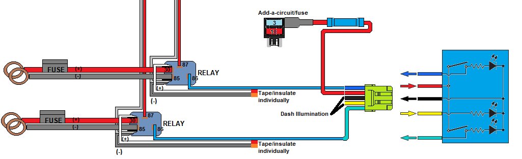

    Hood Struts, My version Fogs always ON, Map & Overhead Light Mod,
    Add-a-fuse to any IGN source (12v Accessory) so switch is not always "hot".
    Yellow goes to any switch illumination wire (Green)
    Black to selected switch illumination wire (Beige)
    Insulate/tape off remaining wires from each relay INDIVIDUALLY.

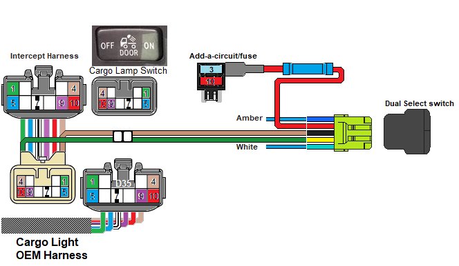

    @kmorgan3 might have the intercept harness for sale.
    With it, you don't cut any wires on the vehicle.
