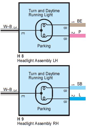

    I figured that but I just need to know the colors of the different wires on the passenger side of the truck so I splice them
    correctly the first time. I tried to order a shop manual from Toyota but the parts guy said they do not sell them. Is there any website that
    has this info.?

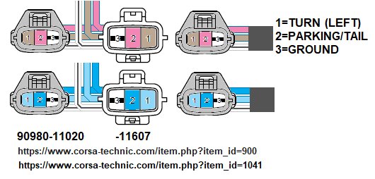

    An overkill harness to tap into Turn, Tail & Ground:
