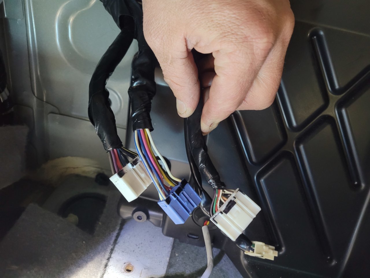

    I must be slow bc I don't get that diagram. I am trying to figure out what wires I need to tap into for front and rear speakers.
  4. Mar 17, 2022 at 7:22 PM
    Stevendodgen3
    Stevendodgen3 [OP] Member
    Mar 17, 2022
    #392863
    6
    Steve
    Tacoma TRD Pro
    I am installing a 5 channel amp, new 8 inch sub, all new speakers. I've got the sub covered, but for the door speakers I need to know what wires to tap into on the harness attached to the amp. So basically the outputs for the door speakers.

  7. Mar 17, 2022 at 7:44 PM

  8. Mar 17, 2022 at 7:45 PM
    Stevendodgen3
    Mar 17, 2022
    #392863
    6
    Steve
    Tacoma TRD Pro
    This is what I'm looking at and the colors on the diagram don't match the colors I'm seeing on the wires. I have no clue, but I need to figure out the wires that go to the door speakers by color or maybe even just the specific plug there are obviously 3 plugs. Idk
  9. Mar 17, 2022 at 8:10 PM
    Dm93
    Dm93 Test Don't Guess
    Mar 3, 2015
    #150066
    13,044
    Texas
    2014 DC OR 6spd 4x4
    Predator tube steps, Ranch Hand grill guard, Magnaflow CatBack exhaust, Toyota tool box & bed mat, 2LO Module by @Up2NoGood, Rearview Compass/Temp Mirror, Tune by @JustDSM.
    Here's the pinout's, looks like A=S23, B=S24, and C=S31
    Beyond that I don't know how else to assist you, you could check around in the Audio/Video subforum I'm sure someone there has done something similar.
