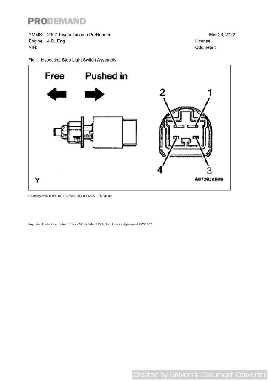

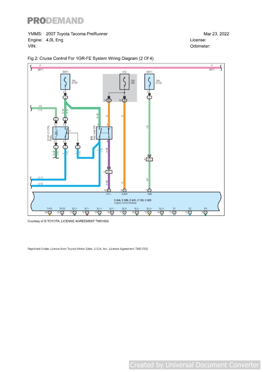

    I'm needing a wire diagram for the brake switch pedal while it was being replaced the wires got ripped out

    This should be correct.
