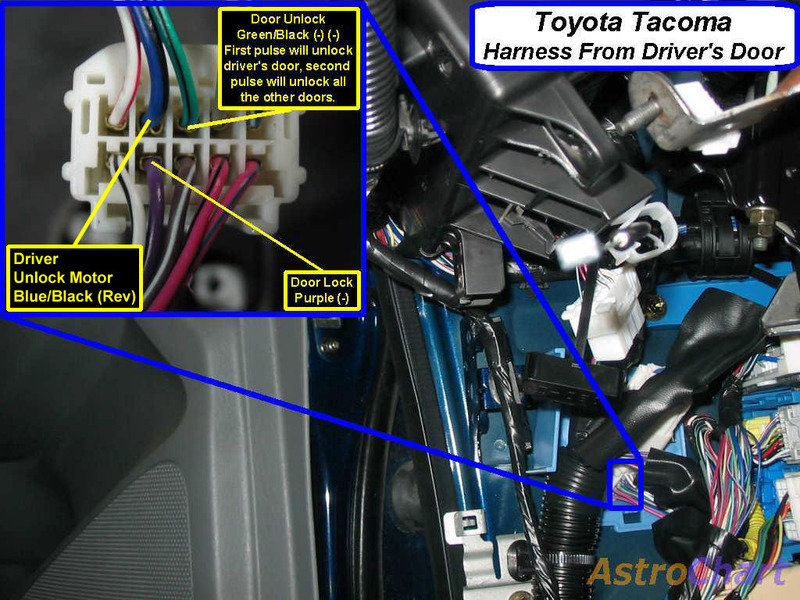

    So you're saying any of these 3 wires on the back side of the fuse block should unlock the doors when momentarily grounded?
    Just took a quick look at the wiring location, but didn't have time to pull the lower dash and fuse block out to access the connectors shown above. Maybe this weekend.

    just send a ground to the disarm wire(green/blk)

    Just tested the wire to ground as user mcnkl recommended. Worked perfectly. Most likely going to order a switch a pick out a hidden spot for this mod now

    That's awesome! So just to be crystal clear, all you're doing is tapping into the green/black wire, running one side to a switch, and just grounding the other side?

    Yup. Need a switch first though.
    For a test I just hooked up a jumper to the green/black and tapped it to chassis ground. One tap opened the driver door. Two opened all doors
