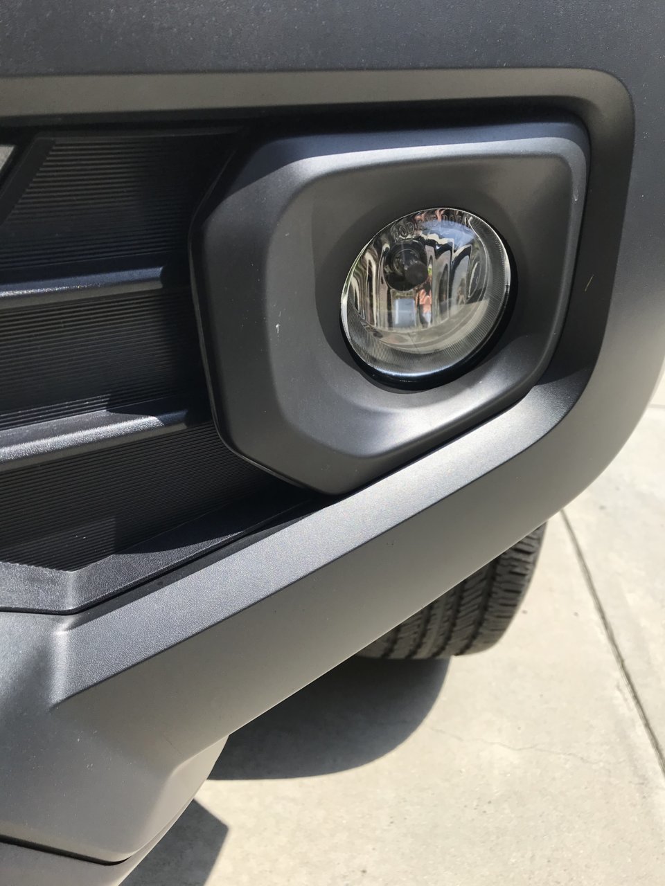

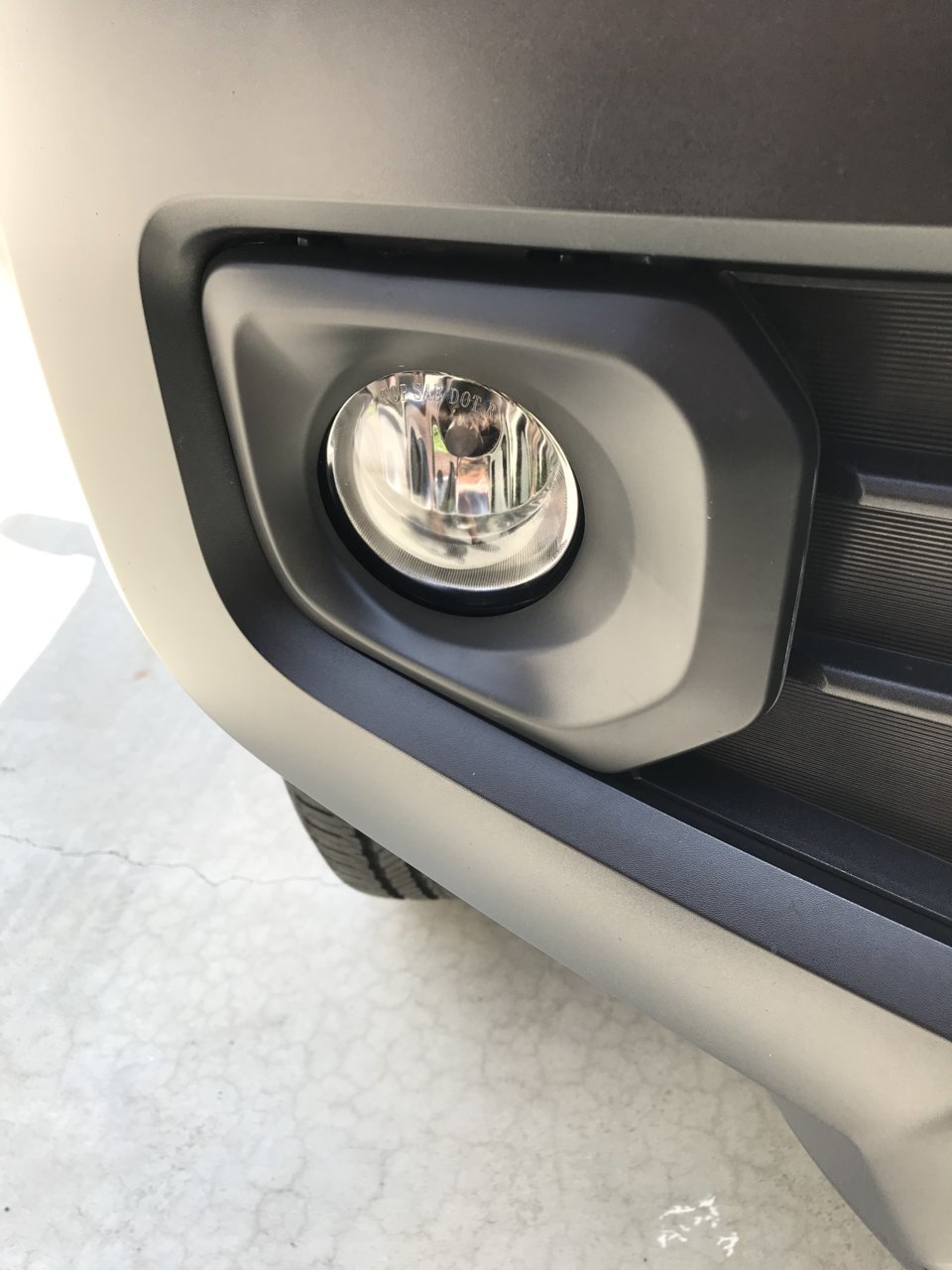

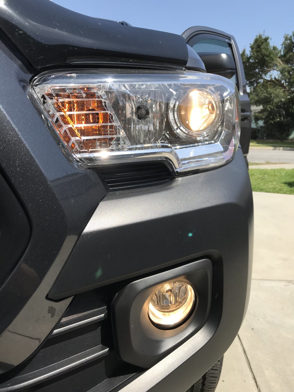

    The kit came with halogen fog assemblies, plastic bezels, bulbs, and the complete wire harness preassembled with fuses and an optional switch for the cab but I cut that part off.

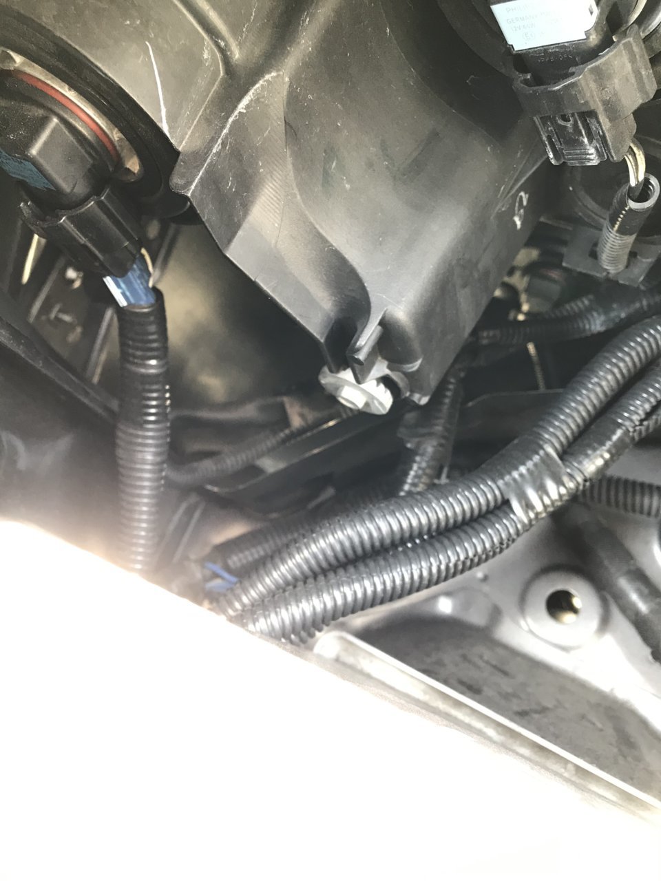

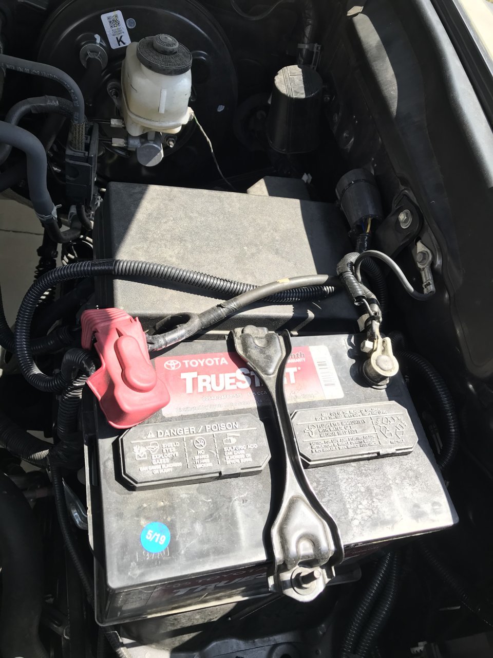

    The fog bezels are ok but my plastic bumper is a little warped so I used double sided tape. The fog light screw goes behind the bumper. I added the wire loom to clean up all the wire. The last pic shows where I tapped into the low beam.

    My bad, misread it. Also been a while since I installed the fogs. I tapped into the low beam wire but I guess it is possible to have power when the truck is on with the drl.

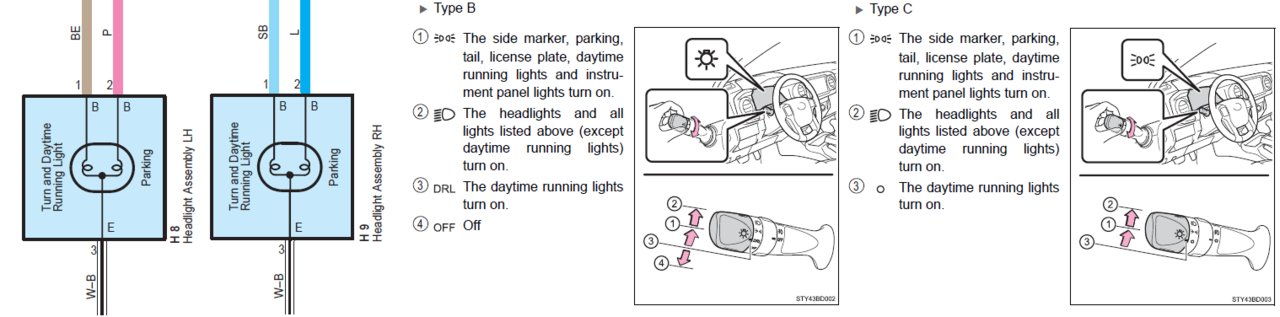

    SR DRL is Turn signal also (incandescent bulbs) and turns OFF when headlights are selected...

    When you turn on the headlights the DRLs drop one of the 2 filaments and become marker lamps. When the headlights are off or a turn signal is on, the second filament fires
