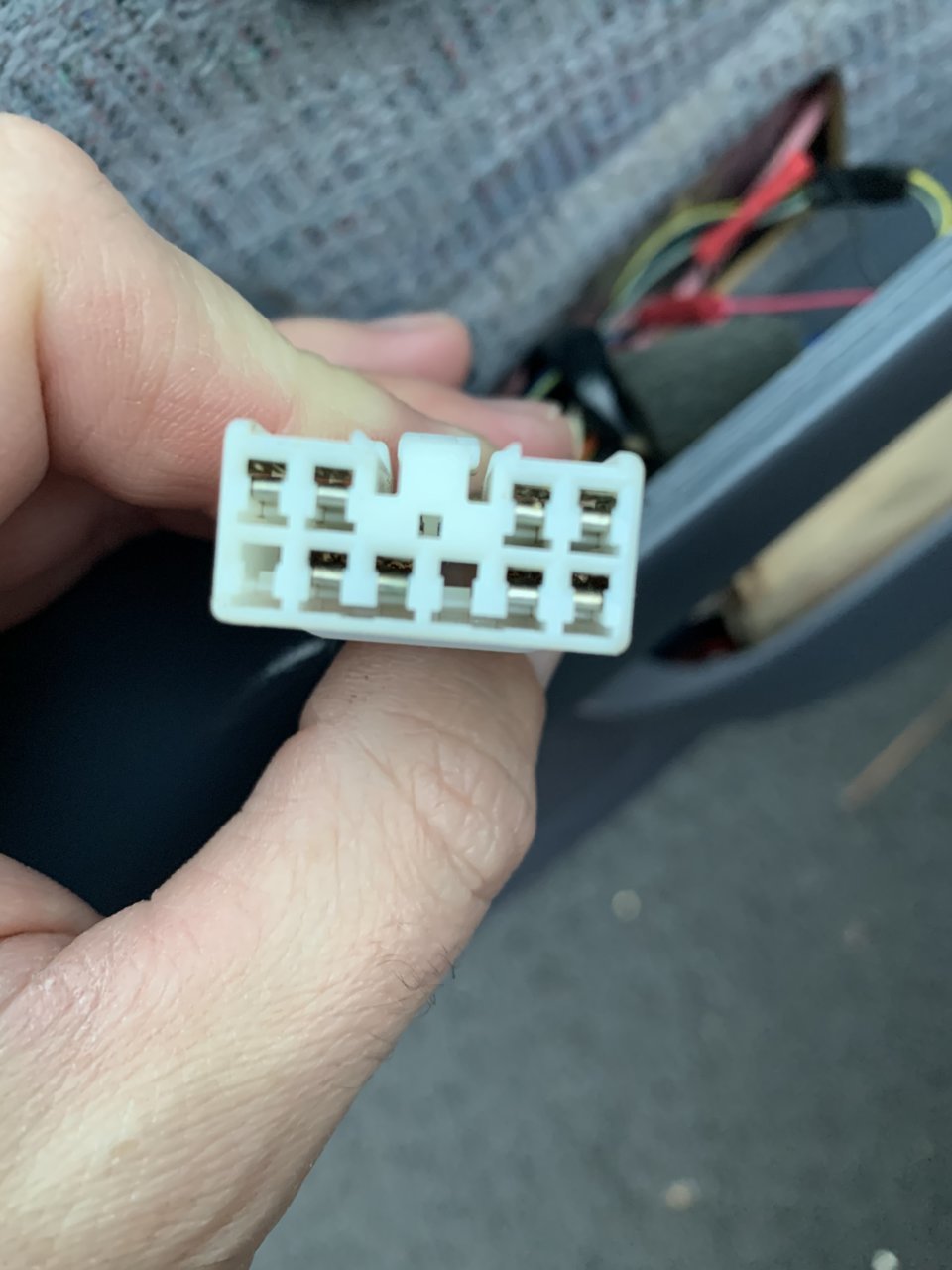

    I couldnt find a model number on the connector but i was looking through the catalog...Do you think it is any of these ones?

    I have 10801 on my connector, see pic, does that match yours?

    The number is on the back of the connector where the wires go in, as long as yours isn’t too trashed you should see it.

    Pretty sure it's the one with the question mark in the picture.
    You will probably need a repair wire for that connector too. You can find that part number in the same pdf.

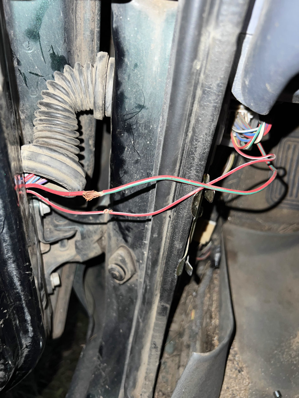

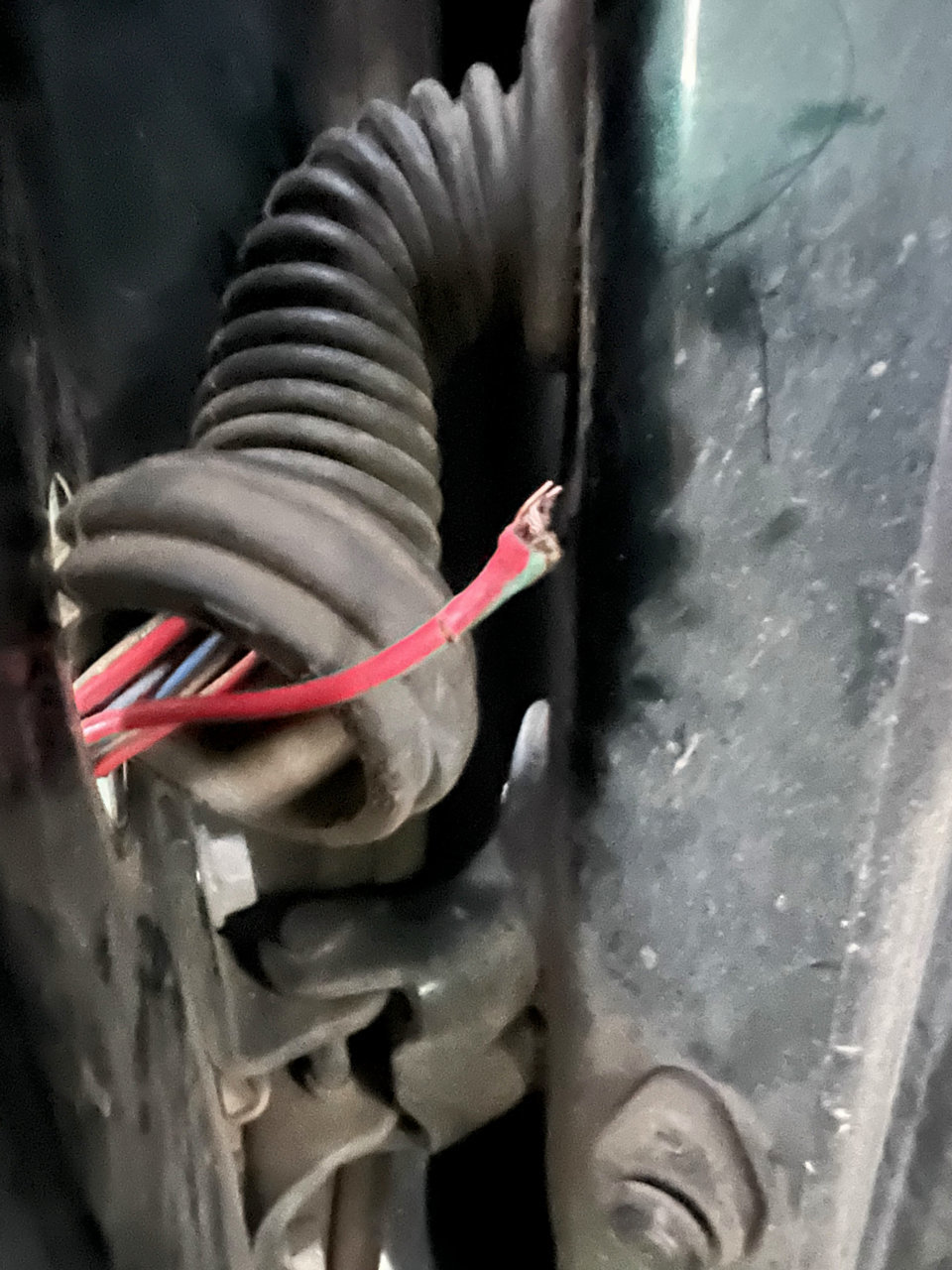

    Has anyone on here replaces the whole wire harness? My passenger window stopped working on my 2000 and after changing the switches and checking the motor I found the issue was cut wires in-between the door jam.
