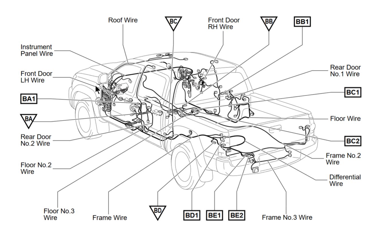

    Here are the wire routing drawings you need.
    https://www.customtacos.com/tech.ol...oyewd/06toypdf/ewd/2006/tacoma/g/em01d0up.pdf
    hemitruk and 6 gearT444E like this.

    Zoom in on this image:
    You will see where the rear tailight assembly wires come together on the drivers side and enter the cab through a grommet into the cable tray under the plastic cover. From there it goes into the drivers kick panel. In there you should be able to locate the connection.
    6 gearT444E likes this.

    This diagram is priceless!! Thank you!!

    I changed it with one that isn't so cluttered... Look again.

    Glad I took a screenshot of the first one. Now I can use both. My high mount brake light doesn't work. I put a continuity tester light to where the wire connects to the main junction box near fuse box. It lights up as expected. Nice and bright. When I get the tester on the harness/female side of the connector at the light, I get a VERY dim light. Not enough voltage to light up incandescent or LED bulbs. No corrosion at or near the brake light. Guess there's corrosion/open/loose connection somewhere between the kick panel box and the roof. Time to start tracing the wire. This diagram will save lots of time.
    Thank you Jimmy!!
