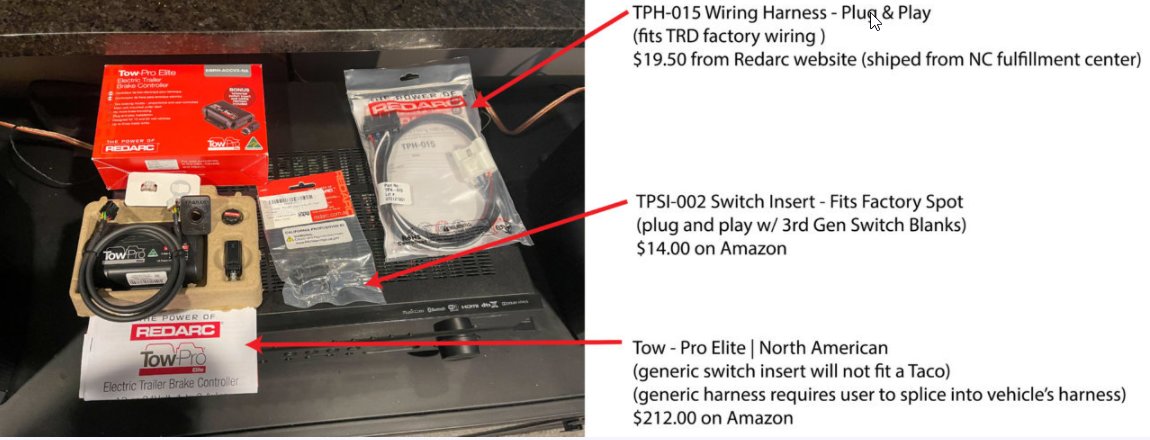

    You set up the trailer brake strength using the knob dial. To activate the trailer brake alone, press the knob.
    Bonus. The Red Arc looks and functions very much like a factory built-in brake controller.

    Yes, you push the knob. Figure 3.2 on page 11 of this .pdf (page 10 of the manual). Check out this post for install pictures / my setup.
