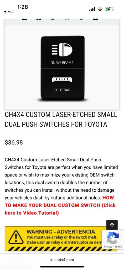

    Hi Dave, hoping you can help me out as I know very little about wiring. I have a 2023 TRD OR with LEDs.
    I recently ordered a light bar from diode dynamics and would like to wire it so that I am able to turn it on and off with one switch, and with a separate switch have the light bar turn on/off when my high beams are activated.

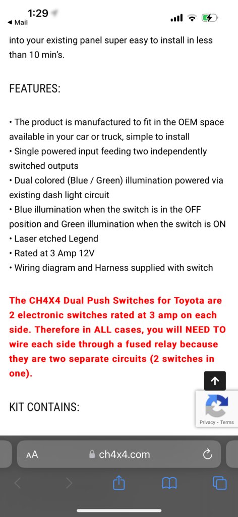

    I looked for a 3 way rocker switch for a while but ultimately ended up buying this SPST set from CH4x4.
    What is the simplest way for me to make this work? Do you sell a product for this?

    Assuming the light bar harness was also purchased and we are ignoring backlight for now, you need one signal to feed the relay.
    The dual push buttons have 5 wires. Two are for switch illumination. You can grab a harness for that from guild outfitters.
    three wires left. One is fused power input. Typically you might want ignition switched but in this case constant battery works. Typically an add a fuse off a circuit which is on without the key. Lots of choices in the in cab fuse box.
    the bottom button output would feed the relay coil through a diode. Then the top button is left. You need one additional relay for that and wire as such:
    85 on the relay to chassis ground
    86 on the relay to the top button output
    30 on the relay fed from high beams. You can order an led T w high beam only from me for this lead
    87 on the relay to a diode to the light bar harness.
    The two diodes ensure no current back flows which would potentially turn on the high beams with the lower button or have the lower button illuminate if the top button is on when you turn on high beams at the stalk.

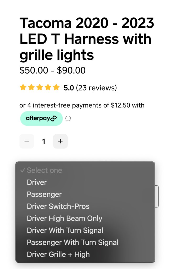

    I am planning on ordering the LED T harness high beam only from you. However, I just ordered some grill lights and was looking into having these turn on when my lights are set to “auto” (on with DRL and headlights) and off when headlights and DRL’s are set to the “off” position. I saw somewhere else on your page a similar instance where you instructed the customer to order the switch-pros version instead of the high beam only to achieve this. I guess my question is should I get my light bar set up with the high beams how I want, and then address the grill lights later, or can I do it all with just a single harness from you?

    I’d prefer a single T w a branch to feed the two pieces over two separate T’s. But that’s up to you.

    If I go with the single T option which harness would you recommend?

    I added a new option for you to make it more straightforward, though it can be confusing parsing all these options. I'll add a photo once I build yours. Driver Grille + High.

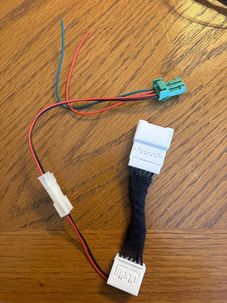

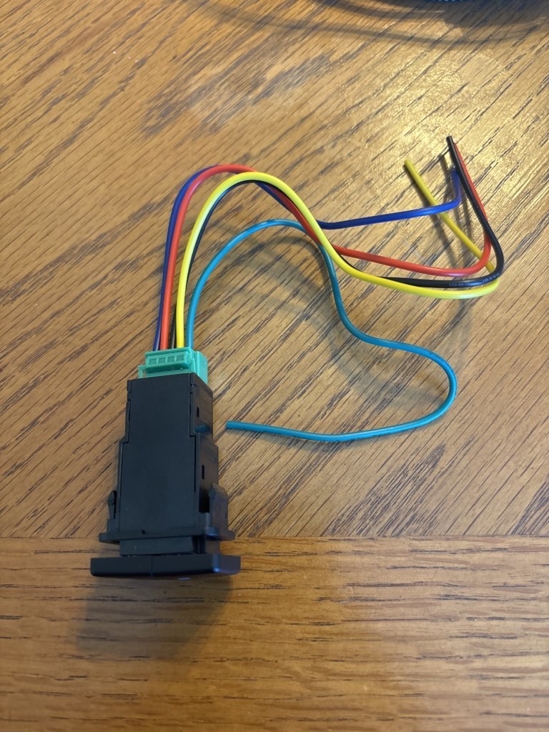

    Hi Dave. Sorry to bother you again. I’ve been tinkering with everything this morning trying to get this light bar installed.
    The harness that I ordered from Guild outfitters is the switch illumination harness with the daisy chain. I’m now thinking that I don’t need this daisy chain (4 wires) and would just need to connect the wires from my 2 switches (5 wires) to the switch illumination harness?

    yeah, the default switch illumination is for a single button switch, for dual switches (top + bottom separate on one switch) then you're stuck either:
    1. de-pin and re-pin the illumination leads
    2. Move the center pin over from the double to the daisy chain
    3. Cut, strip and splice wires directly.
