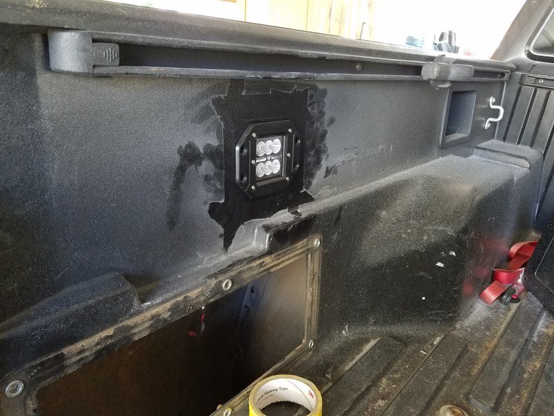

    In the process of installing two led lights on the bed of my truck. Bought a harness from Amazon built by rigid industries specifically for these lights. Everything is basically on the truck, just not plugged into the battery. When both lights are connected, the fuse blows out. When only one is connected everything seems to work fine. Wire is 18 gauge, with a 15A fuse like I said built specifically for these lights. Aside from a possible short, what other things should I be looking at.

    Ran out of daylight yesterday, about to get home and try each one individually. I was also thinking about a different switch, I'll see if I can get them working today. Hopefully I don't have to trace wires, should've tried everything out before putting it on the truck.

    Ok pulled the whole harness out, wired each light individually and each on their own worked fine. Everything seems fine, except when both lights are plugged in it burns the fuse. Maybe the harness is too long? Don't know if that's possible since light are only about halfway on the bed. About to give up on this harness and order a different one.
