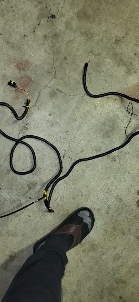

    I have some aftermarket fog lights and a harness, that allowes them to become turn signals too. So my question is how do I do that. They have a plug male/female but the there is a yellow wire that hangs of the insulation. Can anyone help me wiring please?.

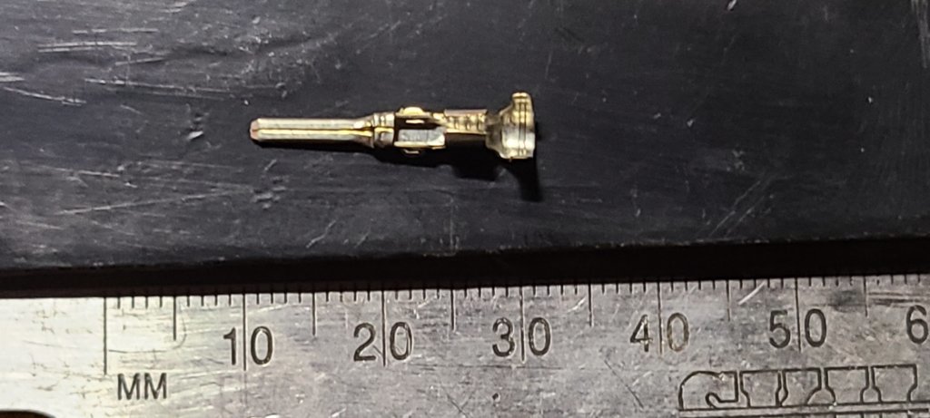

    The yellow wires will ea. need to get tapped into a turn signal lead.
    D.S. and P.S.
    You can pin the ends and shove them into the back of the turn signal wire harness.
    Like so......

    These wire pins will plug right into the same spot as your positive wire.
    (I'm 3rd gen. Can't confirm your wiring color)
