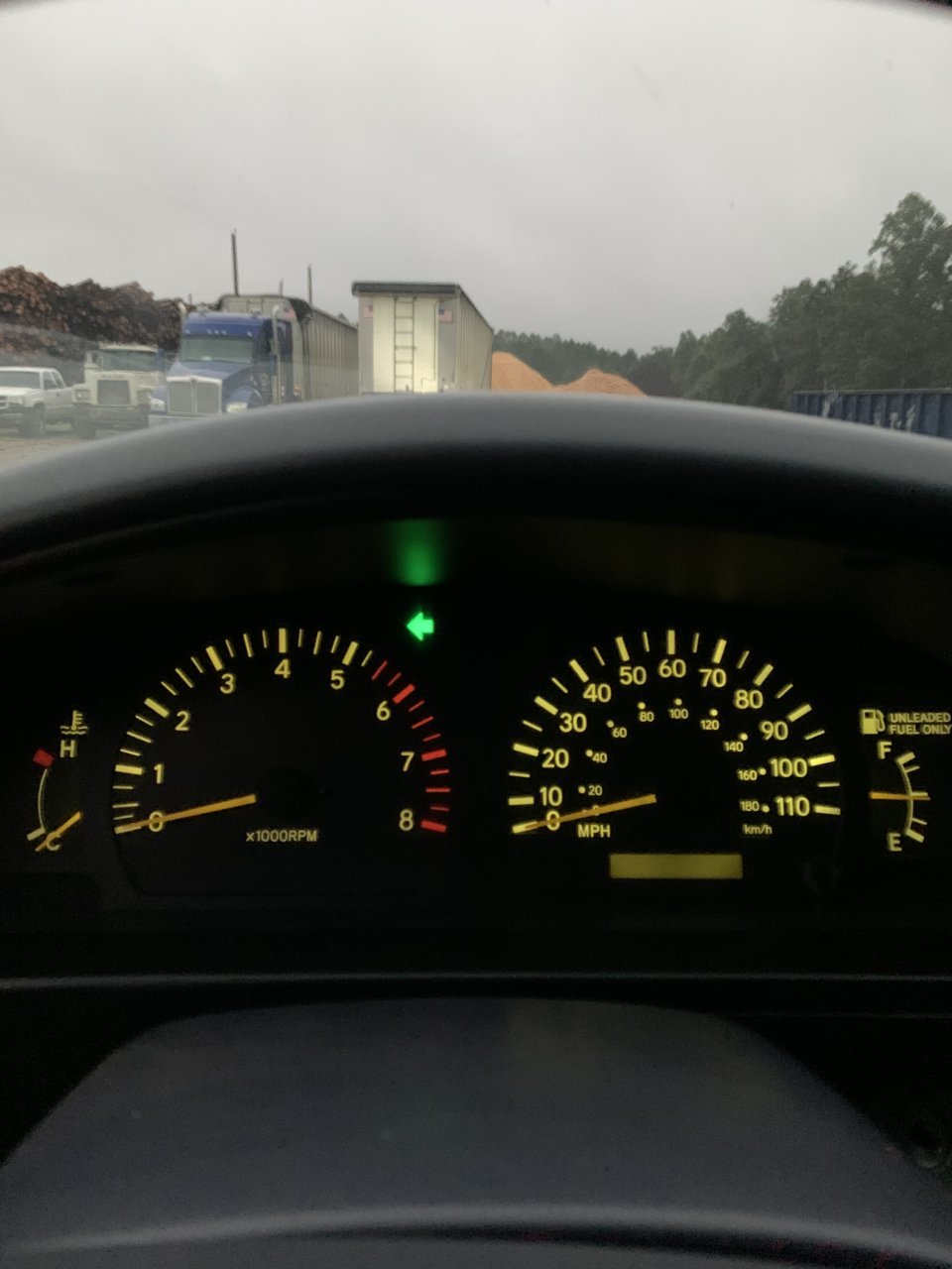

    I have no clue if it’s a bad wiring harness or a bad relay. When I have my headlights on or my corner lights, my left turn signal light stays on and does not flash. But if they are off it works like a turn signal. If I try to use left turn signal when headlights are on it barely blinks and also makes both corner lights blink. Anyone ever experienced this ?

    I have aftermarket tails and only led turn signal is front and it’s not the flashing that’s the problem it’s when my headlights are on or my running lights the left turn signal is on and is not blinking but if I turn my passenger turn signal on that works fine just not my driver turn signal
