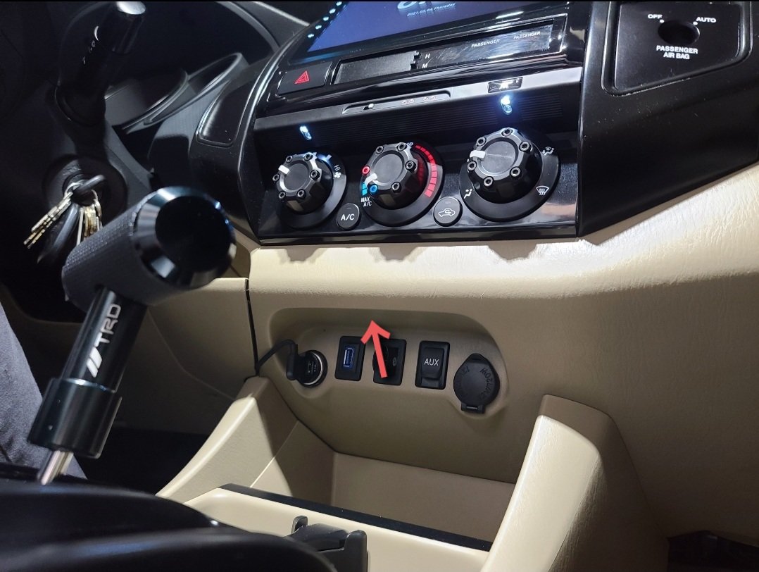

    I'm going to be wiring these low voltage LEDs using a T-tap and I'll be mounting them to the lower part of the center console (just above the aux input).
    These:
    Mounted here:
    My question is, would anyone recommend using the shift indicator light or the hazard/clock light wires to tap into? Both would allow dimming? And if I remember right, I'll be using the green and white stripe/green wires?

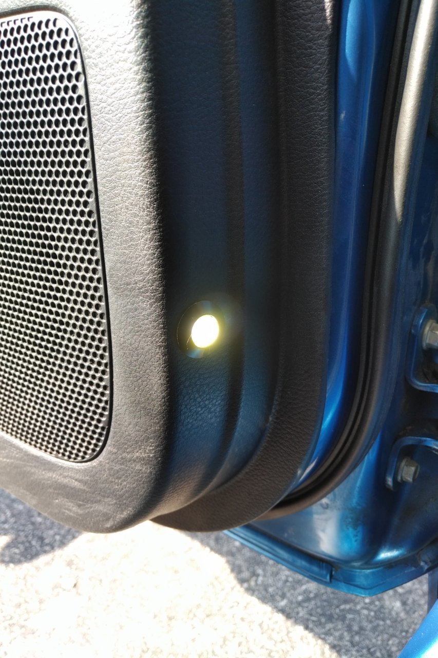

    LEDs draw very little power. There would be no issue adding 1/2 dozen on the same circuit.
    I have a 3rd Gen so I don't have the wiring diagram but if you use a voltmeter it won't be hard to find the illumination circuit you are looking for. Note, Toyota uses the (-) for dimming.
    I have installed LEDs in all my door pockets and tapped into the illumination circuit in the control panel on the door.

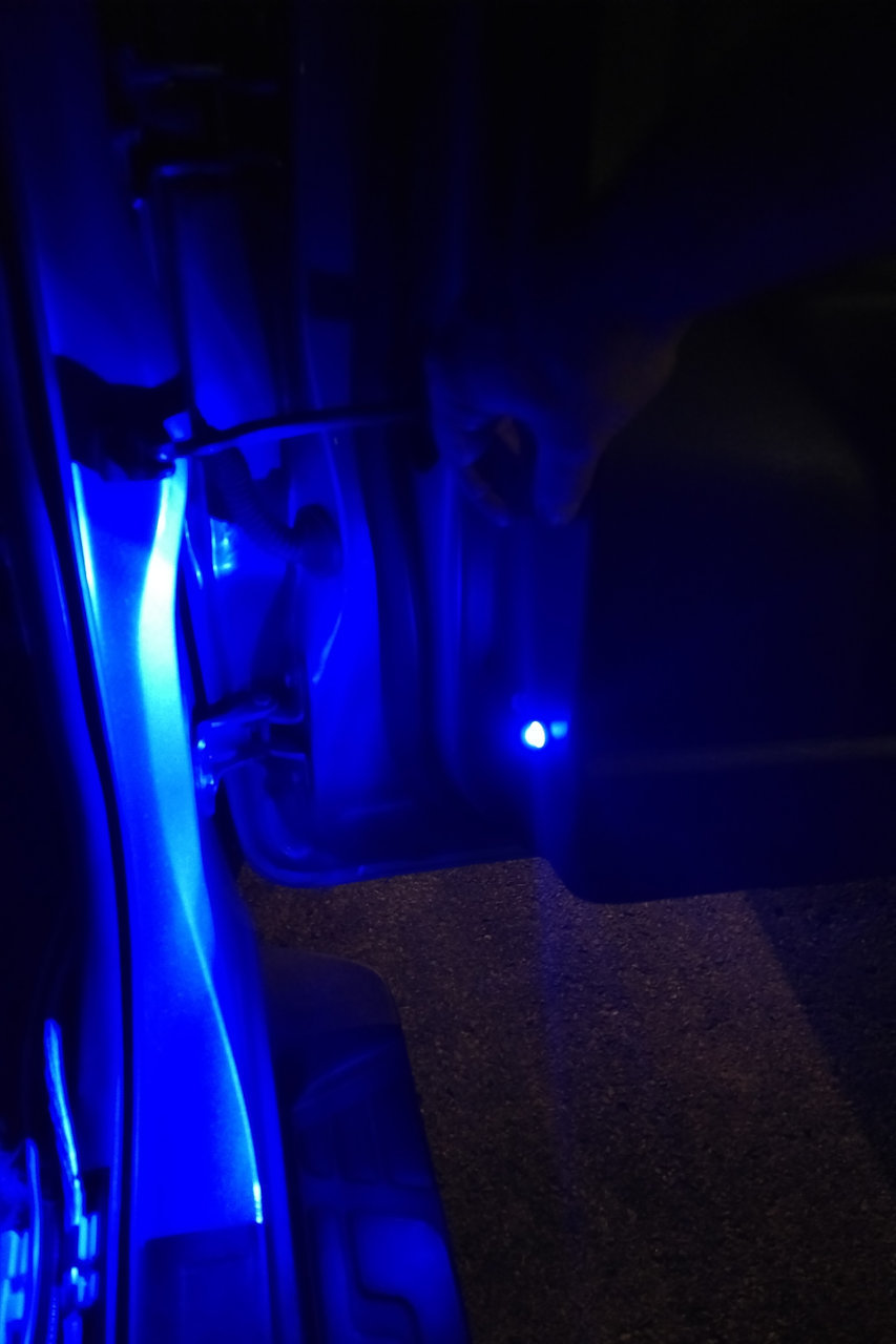

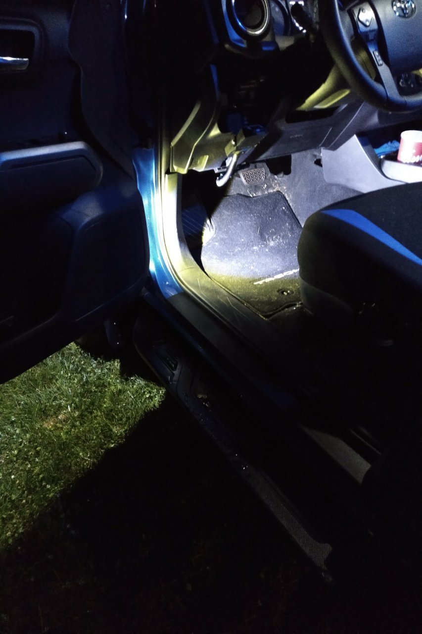

    I also did puddle lights and combined footwell lighting tied into the dome light circuit. I can upload pics if you want some ideas of what it looks like.

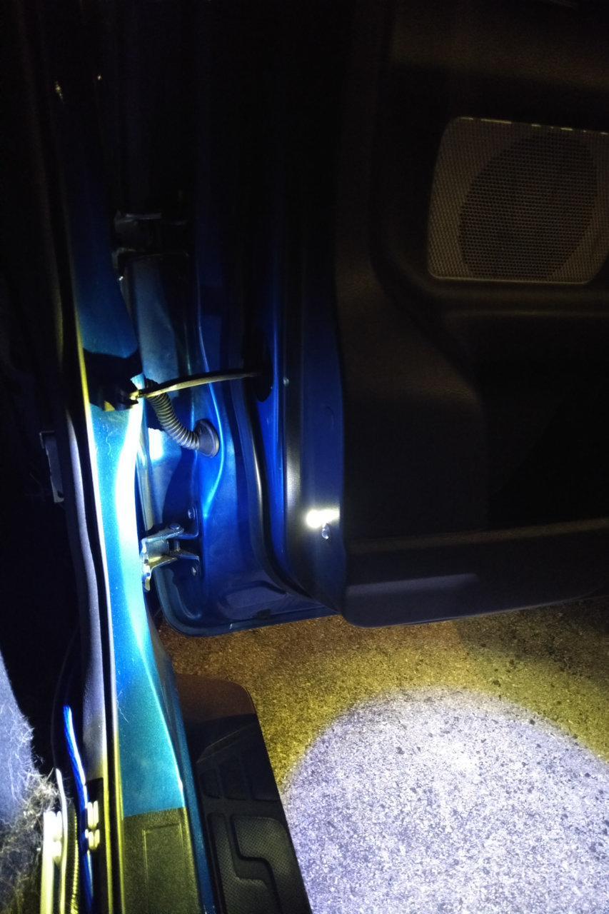

    Puddle lights/ footwell lighting

    Very nice! I'm planning on putting the puddle light position right here.
    What brand did you use, they're very bright!

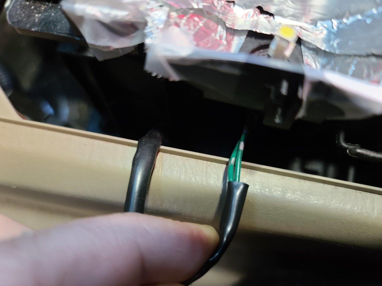

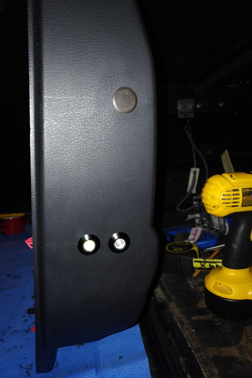

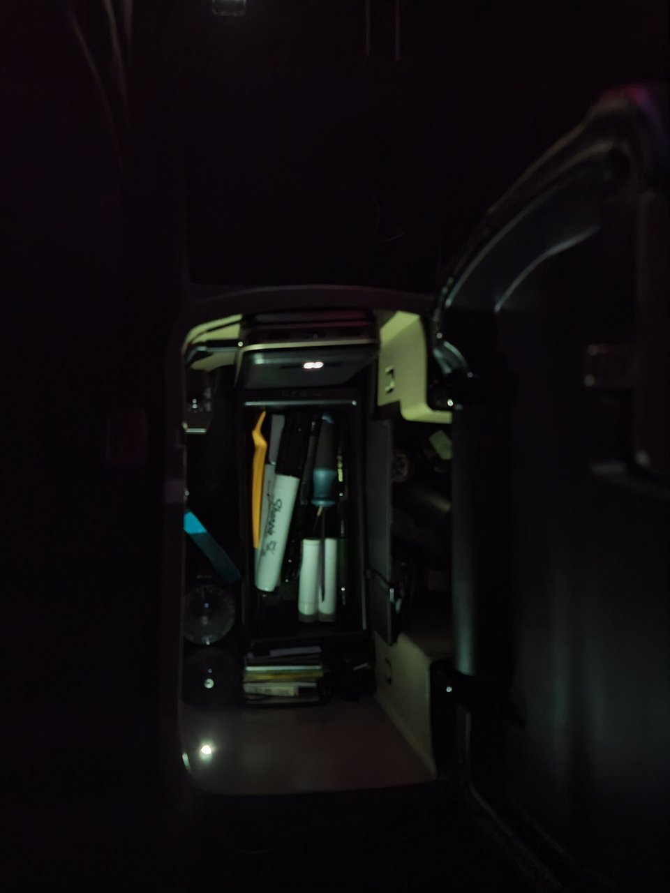

    @oostroma so I took a practice swing. Decided to do the armrest console. I remembered from the climate control swap mod that the I'll+ & ill- were green and green striped. Both wires to the shifter are green with 3 white marks and figured that they were the same. Used the multimeter and I was right.
    Turned out great, just wish it was a bit brighter but it'll do. Super stoked that it dims. I'll post here when I get the other ones in. Thanks again for the advice.
