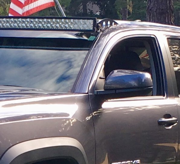

    Run it down the windshield. Hook everything up and then make the cord taught in the small channel and secure it with a few small dabs of clear or black epoxy to keep it in place. It looks clean and no one would likely even notice it
    Edit to add photo:
    I had to zoom it in but the wiring is running down the Black weather strip into the engine bay. I think it looks clean enough to dissuade someone from drilling holes in their roof

  18. Nov 8, 2017 at 7:03 AM
    #18
    dtc1nick
    dtc1nick [OP] Well-Known Member
    Nov 1, 2016
    #201268
    66
    Nick
    Alta Loma, CA
    2016 Toyota Tacoma TRD Sport 4x4
    Falken Wildpeak 285/70R17 Wheels XD Series XD800 Pro Comp Nitro 3/1
    I agree, looks good thanks!
